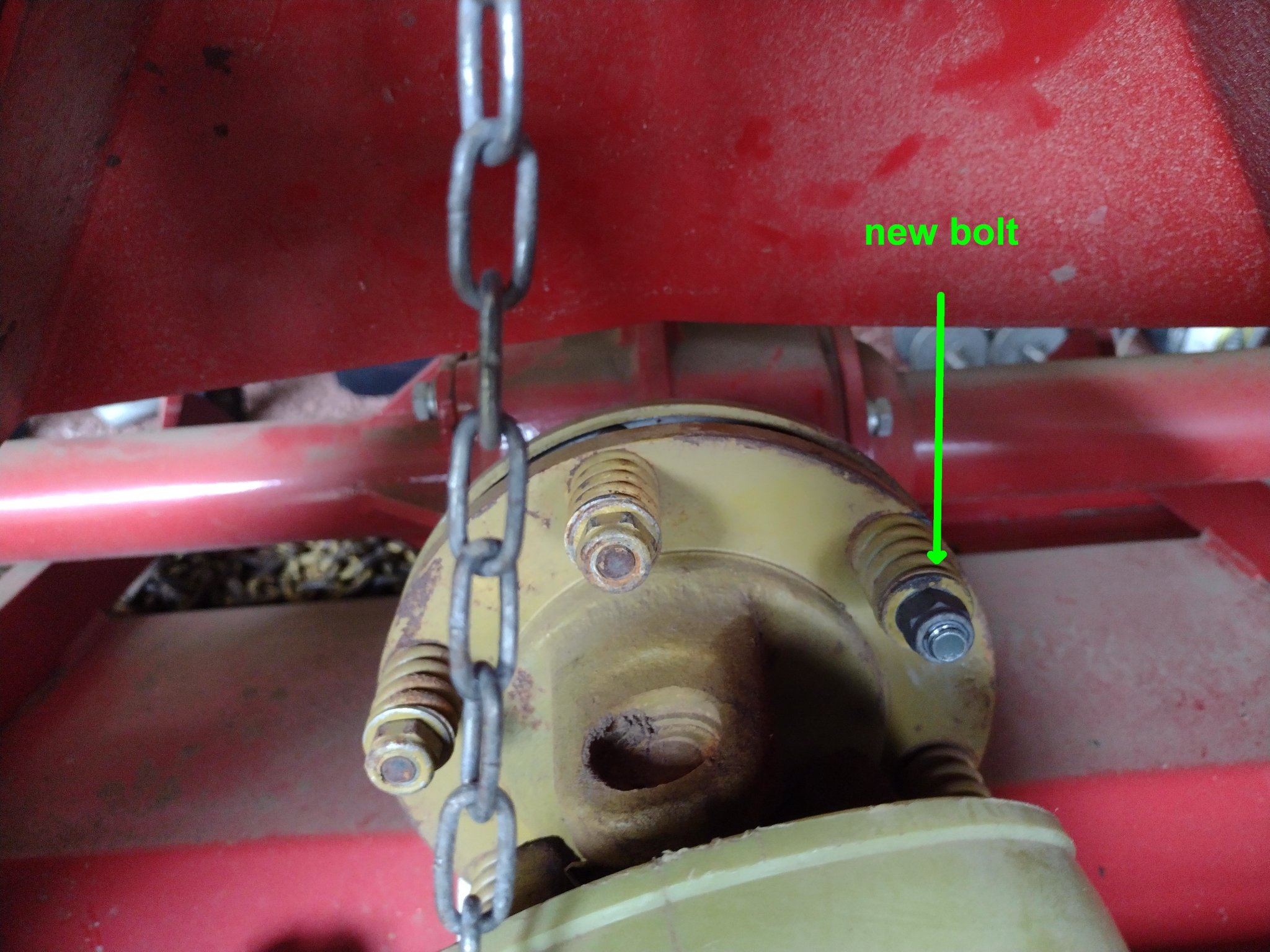

Best take the clutch completely apart to inspect and clean. I bought a tiller from RK that came with the clutch tightened all the way down and had condensation inside. The disc was rusted onto the metal faces. After removing all the bolts I had to beat it apart with a hammer. After cleaning it all up I found the bolts were too short for proper adjustment. I had to buy new bolts and lock nuts a quarter inch longer. If stored in a dry environment you can get by with loosening and slipping every year for a maintenance check but it it won't turn it's time to take it all apart again to clean the rust out.

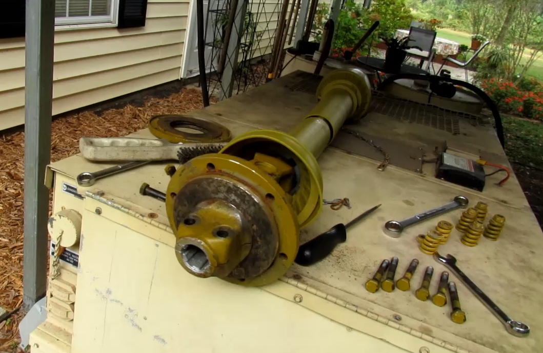

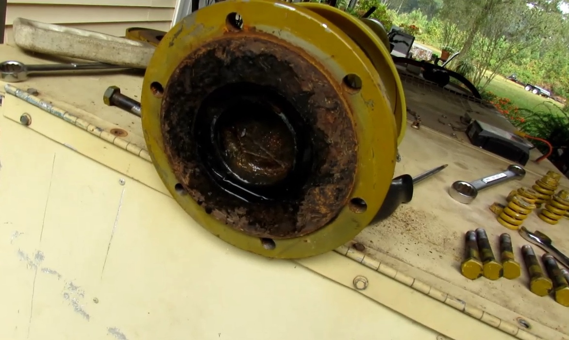

Been down that road. My bush hog sat for two years once, one of the fiber disks stuck to the rear plate. Took it completely apart. Lots of rust, plus one fiber was cracked. Put in two new disks, cleaned, buffed the mating surfaces and put a thin film of grease on the pivot/bushing.
I now take all my slip clutches apart ever few years, just to make sure all is well. I also made a gauge for the spring length, so I am not fooling with a caliper, trying to measure springs.

See Land Pride slip clutch adjustment video (the same content as in my LP RCR manual):
