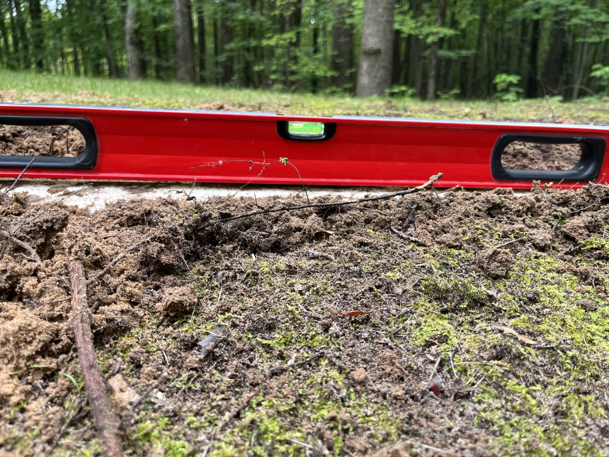

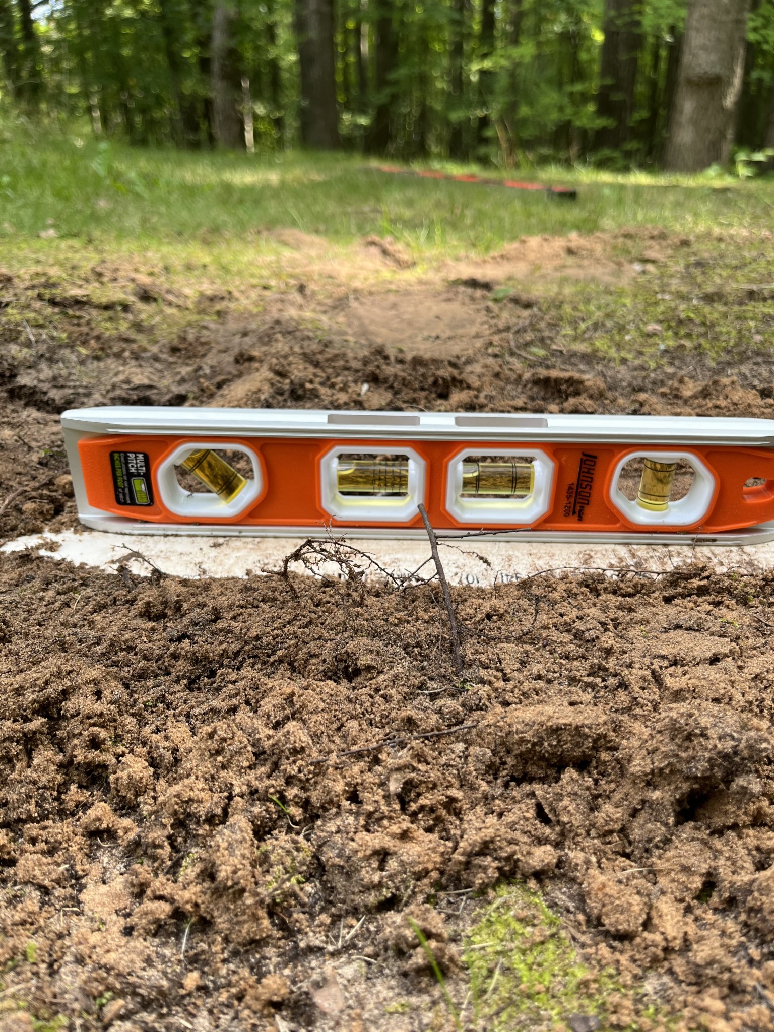

@Motion @dirtydeed
I exposed the top of about a 5 foot length. It appears to be sloping towards the lid/inlet. Here are some pics ignore my landscaping, property is almost 100% shade with horrible soil. I’m putting rocks down in the dug area this fall. There is a a few clean outs in the crawl space with one being right where it exits it, I will have to look for an outside one when I have extra time.

Can't tell from your second pic how long the level is but I see that it isn't on the pipe (left side) .
You're 3rd pic looks to me that you have about a 1/4" /foot. That's good. You really don't want to exceed 1/4" per foot inside the house, but outside it's ok to have a bit more.
Too much pitch allows the water to pass too fast leaving the solids behind in the pipe.

The second pic level is 4ft. It is resting on the left side on an expanded part where the pipe before fits in. I really appreciate you helping me out with this. To say I was panicking would be an understatement.
