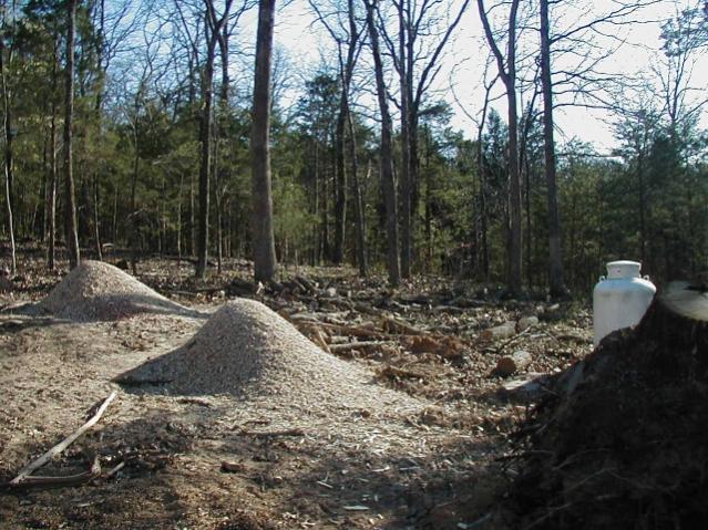

I have a Woodmaxx WM-8M that I used on my L3901DT and it works really well. If you get the WM-8H you can control the in-feed rate so it doesn't feed the wood into the chipper to fast on the bigger limbs. With the WM-8M it has a set feed rate and I have had one or two test that I was chipping close to an eight inch limb and it pulled the engine down. I had eighteen trees push out this last winter and chipped all the limbs from them up. I had five piles of chips the size that is in the picture below, they are about 4' tall.
So, I would say that you would have no problems running the WM-8H with your tractor.
