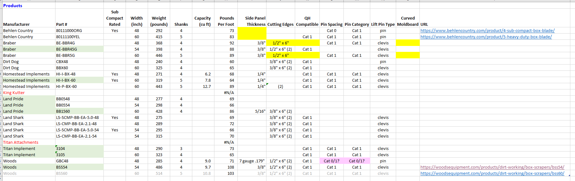

By the way, here is a screen shot of the data I've gathered:

You certainly have 'burnt the midnite oil' with that spec chart, impressive. Well organized!

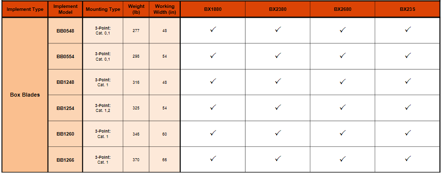

Read the implement match sizing on the Kubota website.
You are gold. I didn't even know that existed.
BX Series: https://www.kubotausa.com/docs/default-source/lp-pdfs/01-bx-series-lp-implements.pdf
B Series: https://www.kubotausa.com/docs/default-source/lp-pdfs/02-b-series-lp-implements.pdf
Here's a screen shot on the box blades section. This is money. Very surprising that they go up to a 66" box width ... but I'm not going to ignore what people have said here. But that they go up to a weight of 370 is extremely interesting.
The below identified implements are either manufactured by Kubota or have received an Engineering Release approving use by Kubota, and thus meet the performance matching requirements for the specified power machines for normally anticipated operating conditions. The specifications below are intended for general application; unusual soil, terrain, or severe operating conditions may not allow for the use of a specific implement under those operating conditions. The use of implements which are neither manufactured or approved by Kubota for use with the specified power machines and which do not meet the below specifications may result in malfunctions or damage to the power machine, damage to other property and/or injury to the operator or to others. Any such malfunctions or damages are not covered by the Kubota express limited warranty. The power machine, implement, and operating conditions need to be evaluated and monitored by the operator to be sure that the conditions are within a safe operating envelope for general use.
