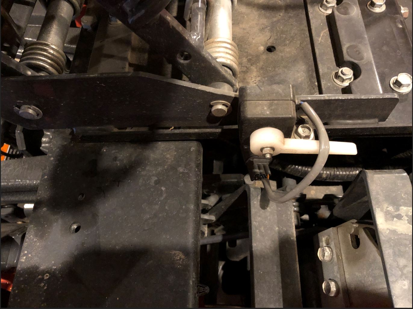

DOES ANYONE KNOW HOW TO DEACTIVATE THE SEAT SWITCH ON A L3301? SHORT OF PUTTING A CONCRETE BLOVK ON IT?
I HAVE TO STANDUP TO HOOKUP MY FL ATTACHMENTS AND THE ENGINE KEEPS SHUTING OFF.

You can install a bypass rocker switch in an open slot if you have one. Common practice for things like running generators when you have a fixed seat vs. the tilt up. Did one on my L5460 when I put an air ride seat in.

I simply made a jumper for the switch
