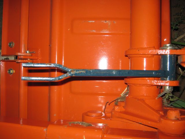

A couple of questions to those in the know, its missing the 2 arms that connect to the tiller to the upper rear lift arm on the tractor, does anyone know the lenght,diameter and hole sizes of these by anychance as i may try and fabricate a pair rather than search for a used set.

Hi Rob
Mine are 170 mm long. A few pictures attached. I think anything approximately this size will work and it would be easy to fabricate something up.
You could easily add wheels if needed. They don't really do anything apart from keep the tiller at a certain depth from the soil surface. Without then you will till to different depths.
