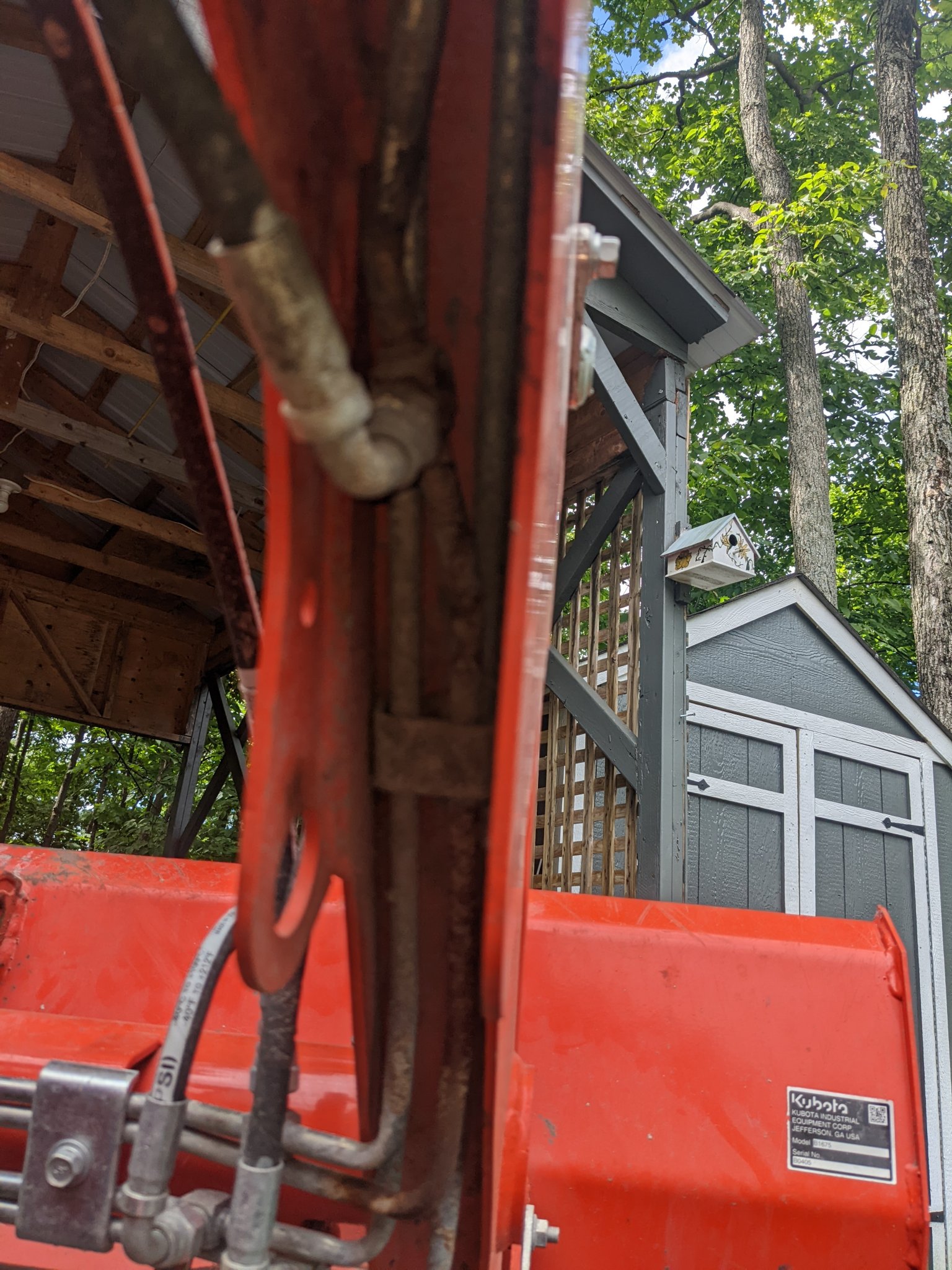

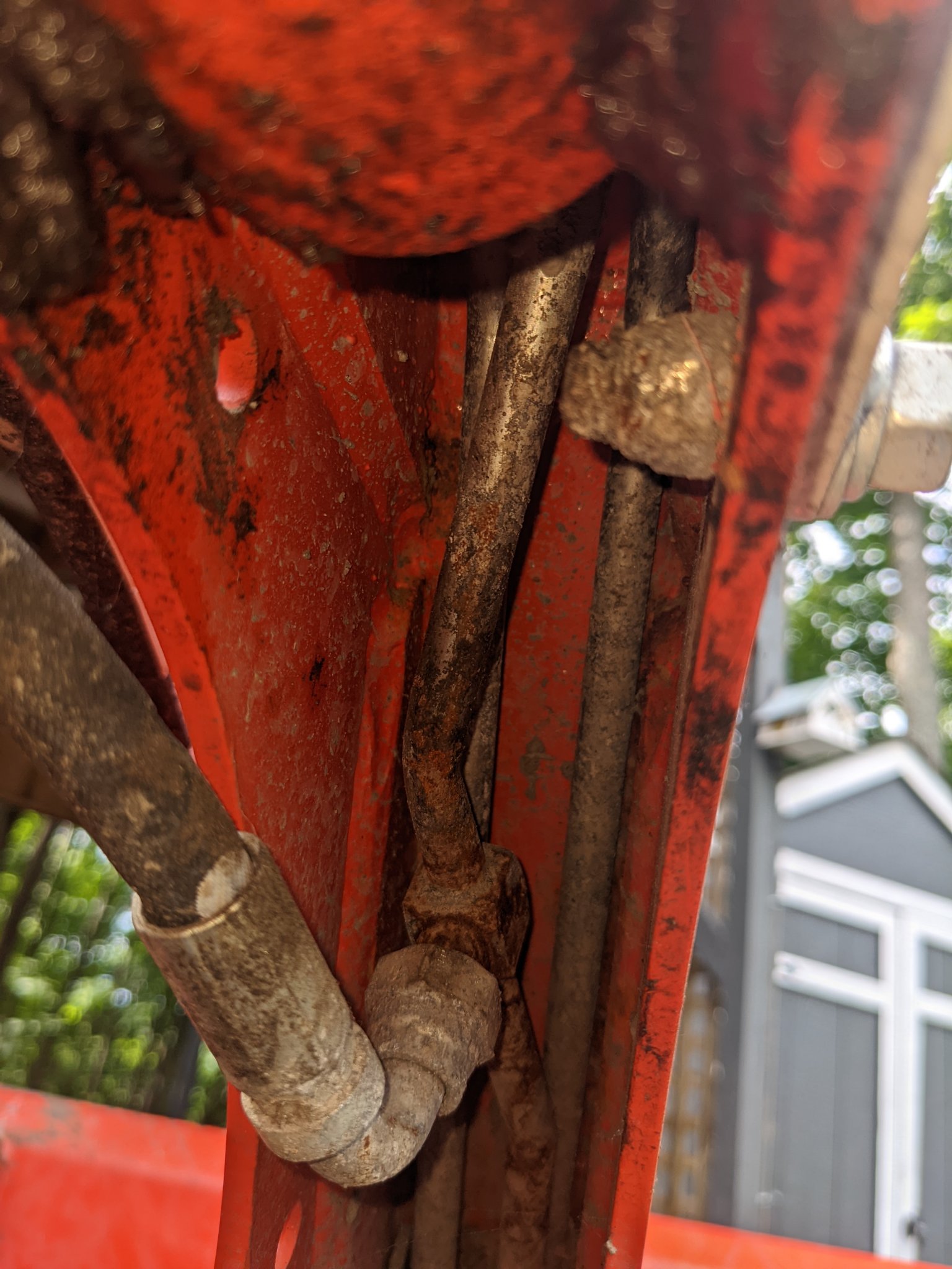

My tractor has 146h on it and less than 2yo (so still under warranty). I noticed that the hydro line on the FEL are getting rusty. This is probably due to salt on roads last winter.
Is this considered "normal" ? Should I be worried? I will obviously need to replace those at some point, but should this be covered by the warranty?
What can I do to protect the tractor against this in the future? That salt has completely destroyed the wiring for my work lights. Seems like I should be spraying some kind of rust protection everywhere

Are you trailering your tractor all winter? That things a hot mess!
I've just been plowing my driveway, and therenis not salt on my street. But I then plow a trail that I use for my morning runs. I have to use a salted road to get there. I've done this no more than 5 times last winter.
Aren't those lines supposed to be stainless steel?

Stainless steel is not rustless steel. It can still rust as evidenced by your lines. I doubt your warranty will cover replacement of them, but you can give it a try. Salt is sodium chloride. Stainless steel and chloride do not play well together and chloride will win every time.

Unfortunately, I highly doubt warranty will cover rust, as they will blame the rust on the conditions you used your tractor in.
The best defense is frequently washing the tractor anytime it comes into contact with salt. That's obviously hard to do in the winter.
Some guys coat parts of their tractor with an undercoating like Fluid Film or similar.

Your probably good for another year, but I would get the new ones ordered. Yo might get aftermarket ones made at a hyd shop ?, but they would probably want the old ones for a pattern. Blasting them with fluid film, will help, but those lines are doomed.
8,005
5,172
You could remove the lines, clean them up a bit with a light sanding, and then coat them with OSPHO.
Several days later you could coat them with a two part epoxy paint.
They will last for many years if you do this.
I think you will be unpleasanly surprised at the cost, if you replace them, and the problem will only reoccur.

Alright. I sent those pictures to the dealer and they said itcs nothing to be concerned with. He suggested spraying with krown oil. Hard to find around here. I guess any rustproofing spray would work.
@fried1765: good idea about cleaning them. I'll.do that. I need to rustproof my wiring too. So I'll just spray that oil on there too I guess
