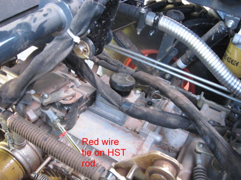

We've adjusted the 'servo regulator screw' the one pictured here in my post, but never touched the 'servo screw' the one you mentioned. After reading the manual for the 10th time, just realizing there are two servos mentioned and one is actually called the servo regulator. I never noticed.
Perhaps that is why my 1100 has always been difficult to shift. I've been concentrating on the wrong servo screw.
