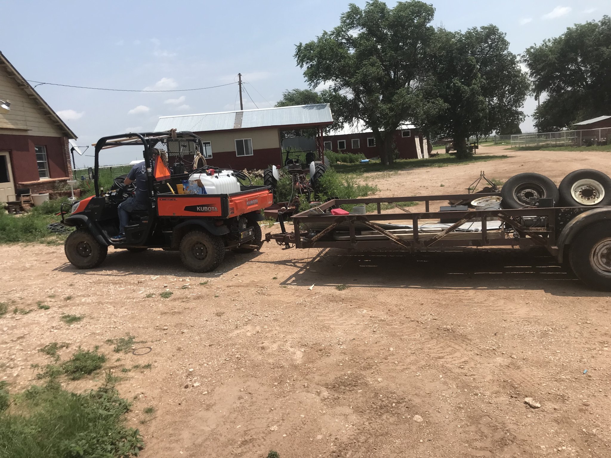

My personal experience is 12VDC transfer pumps are too slow to be useful. I have a similar poly sprayer tank and it works ok for spraying from my UTV.
For watering I use a 250 gallon tote on my loader forks or on a trailer with 2" water lines and use gravity to drain. I've got a 2" gas powered pump to refill the totes from a pond.

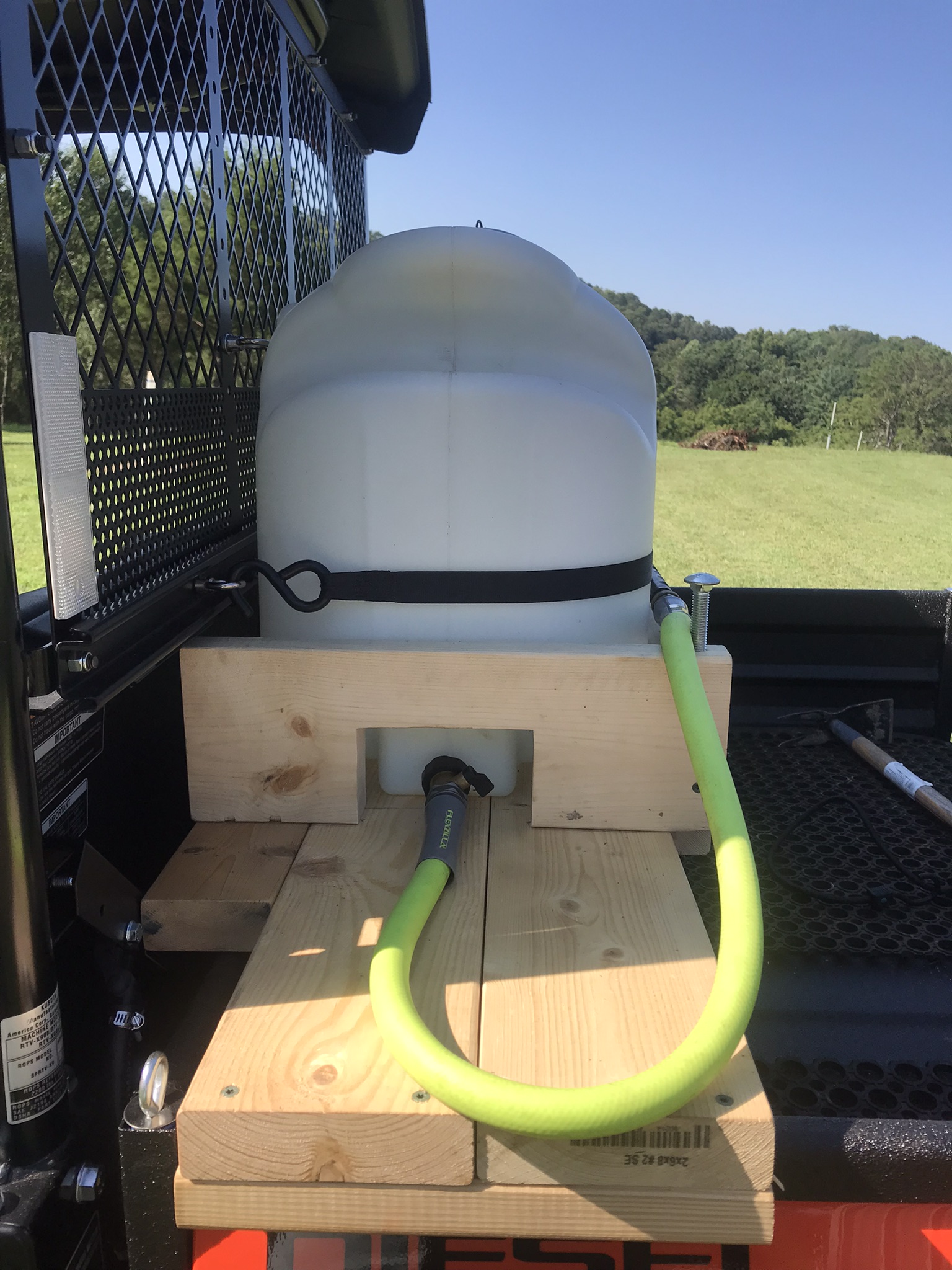

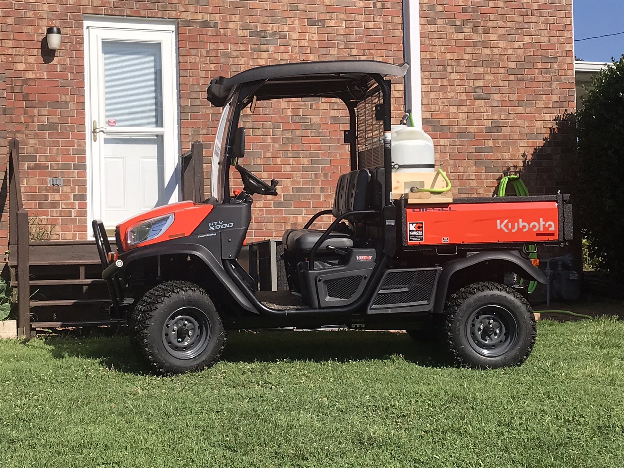

I have used the Northern tank you listed for the last two years. I built a platform to hold it that works very well for me. I use it to water trees and other plants. The nine-inch "mounting" measurement is misleading. The actual tank is about 15-inches wide. My property has some VERY steep slopes and the unit is stable as I have it mounted. It takes less than two minutes to install or remove the platform and tank. It cost me about $18.00 to build the platform. Photos attached
I iike the idea of that platform, i might do a variation on it. Looks like you use it without a pump. Gravity feed is probably enough and with the platform raises the output port above the side. :)
Nice catch on the width, I would have been surprised and not too happy.
Thanks for sharing the photos!
