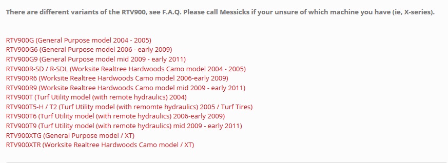

I would like to look at the parts illustration for your machine but discovered there are many different models of RTV900
Can you please clarify which one you have.

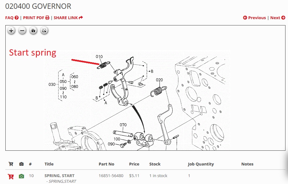

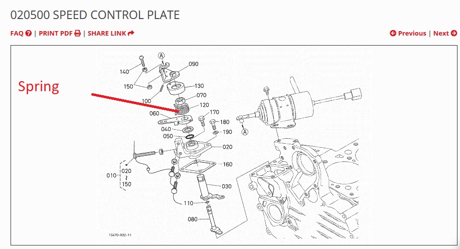

As you look at these images keep in mind I have not worked on this engine.
I suspect there is a missing spring. Particularly one called a start spring.
The solenoid, if it has no spring inside, has to be working against a spring to return the plunge to a position where the engine can start..
There is an external spring but also an internal one.
Worth checking out

The external spring is there for sure. I have not taken things apart enough to see the internal spring, but I triple checked with my fingers that the arm is indeed putting tension on the solenoid to help pull it out, so I feel good about the springs.
Next, I removed the solenoid and quadruple checked that the arm is naturally moving to the position it would be in if the solenoid were in the out position, making me feel even better about the springs.
I bench tested the solenoid again and all was good (again), so this time when I reinstalled the solenoid I was very careful about how I positioned it. The solenoid has two slightly oval holes used to bolt it to the motor and there’s just a little bit of wiggle room – maybe a millimeter or two. When I bolted it back this time I made sure it was mounted as far in the direction of the extended position as possible and now it’s working. I’ve tested it half a dozen times and it continues to work.
I’m still a little pessimistic about it, but it seems right now that my problem with this third solenoid was probably positioning. Or Mark was right from the start and it was corrosion or a bad connection, but this thing is super clean and I checked connections dozens of times. I’ll keep an eye on it and see if the problem returns. As I said, I’m not convinced the problem is solved for good, but it’s hard to troubleshoot further when it’s working.
