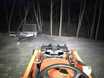

I bit the bullet and bought a 3 light set from Ropslights.com. A little pricey but I’m no electrician and I wanted to make it easy on myself. The lights looked real nice and I spend a few hours routing everything to make it look professional. I turned them on when it got dark and went for a little ride, boy were they bright! They lasted for about a minute and then went out. I checked the fuse box and I had a blown 5 amp fuse. The lights are plugged into the auxiliary wires under the right rear fender of my B2601. A 5amp fuse seems awful small for an auxiliary outlet, no? I guess these guys sell a bunch of these kits and I would think the lights should be sized to work with my tractor. I can’t find out what wattage the lights are but they say they are 4560 lumens each. I emailed John Elliott at ROPS Lights and I’m waiting to hear from him. I was just wondering if anyone had any thoughts on the matter. I got one picture before they blew.

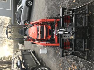

So I think I have everything worked out. I cut the plug off of the cigarette lighter and spliced it into the work light wires. I then added wires from the auxiliary power and soldered them to the cigarette outlet. My work lights now run on a 10 amp 120 volt circuit and my cigarette lighter jack is now a 5 amp 35 volt jack. I ran all three lights today for about 20 minutes with now problem. I use the cigarette jack to run my yellow led flasher. It was a pain in the but boy they are bright! Here is the tractor with the lights and a few pictures of my new grapple.
