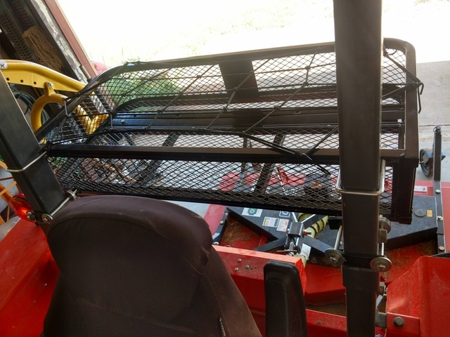

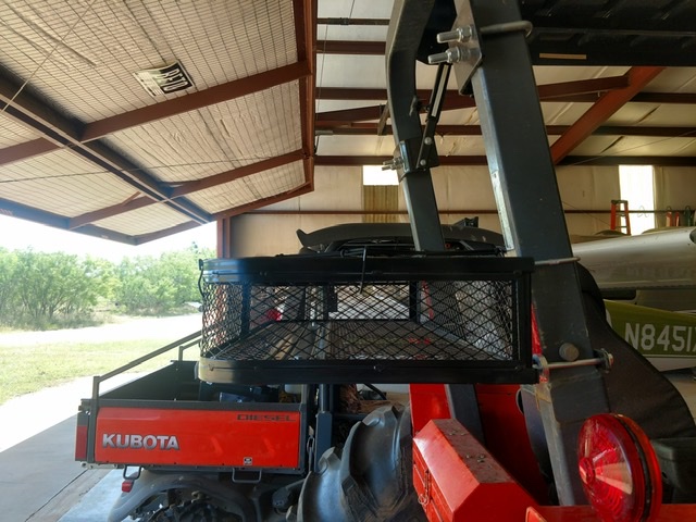

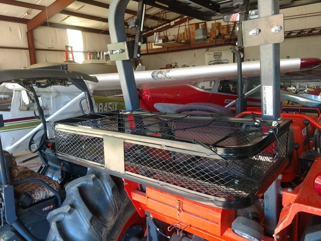

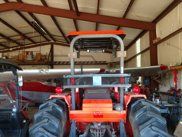

Why not mount a toolbox on the ROPS cross bar? Like this:
6,288
3,629
I used an ATV front-mount rack (and square U-bolts from TSC):
