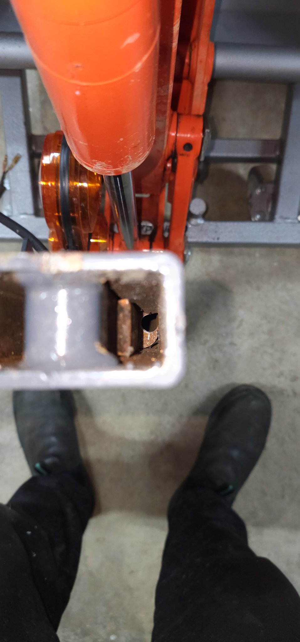

Update to running the wires.
Once the ROP bases were removed and I got a look from the bottom, the fight was on. After about 1.5 hours, struggling, there was no way to get the wires through. I tried fish wires. Forget it.
I decided to try drilling through the baffles. I used 12" drill bits. The first was 1/4". After getting through the baffle, I swapped to a 1/2" drill bit and made the hole bigger. It was tedious, but it can be done. More to come

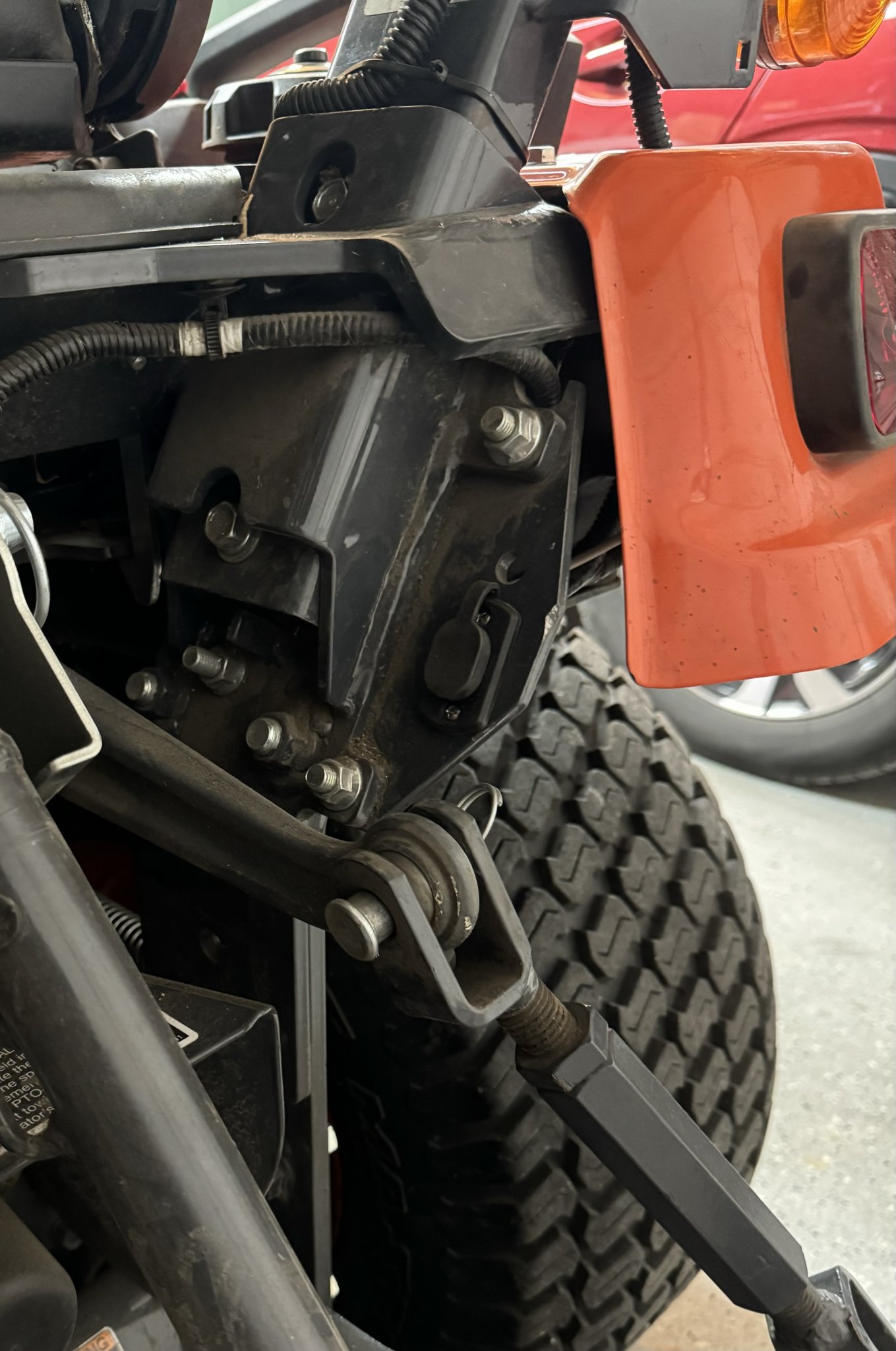

I'm gaining. All wires followed factory (planning ahead), but not attached to the fuel pump line.
And I thought Japanese vehicles were a headache. The factory wire harness routing is strategically snaked. I followed them with my looms, and zip-tied along the way, clear of all moving parts.
Both my wire looms exited the back, directly below where the ROP bolts to the frame.
Feeding the wire loom UP from the bottom was pretty easy. Prior to setting the ROP Bar in position, extra loops of wire were stuffed inside below the pivot point. It may be useful at a later time.
I'm currently at the "plan the mounts-mounting stage.
All splices have been soldered, heat-shrinked, wrapped with elect tape.

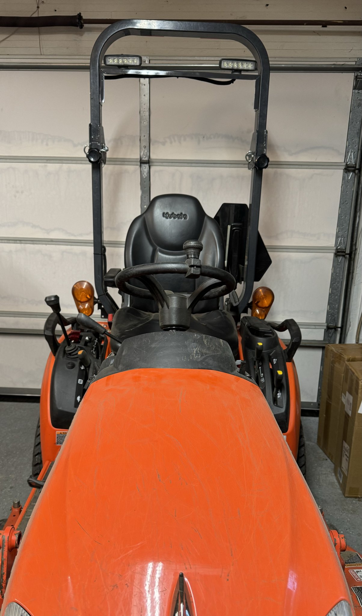

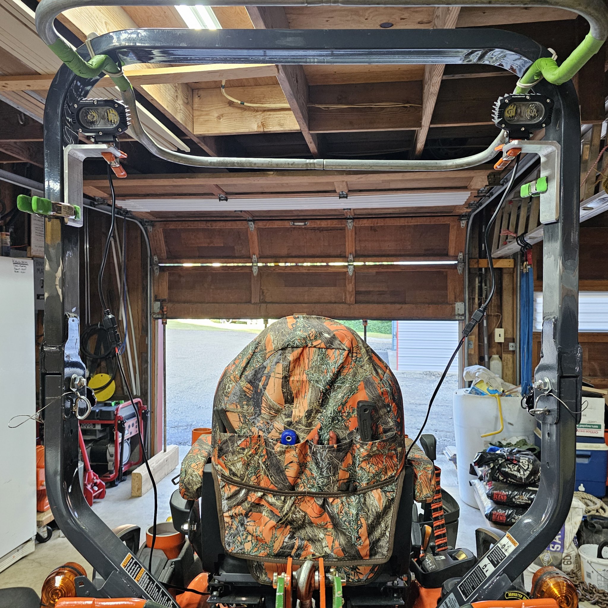

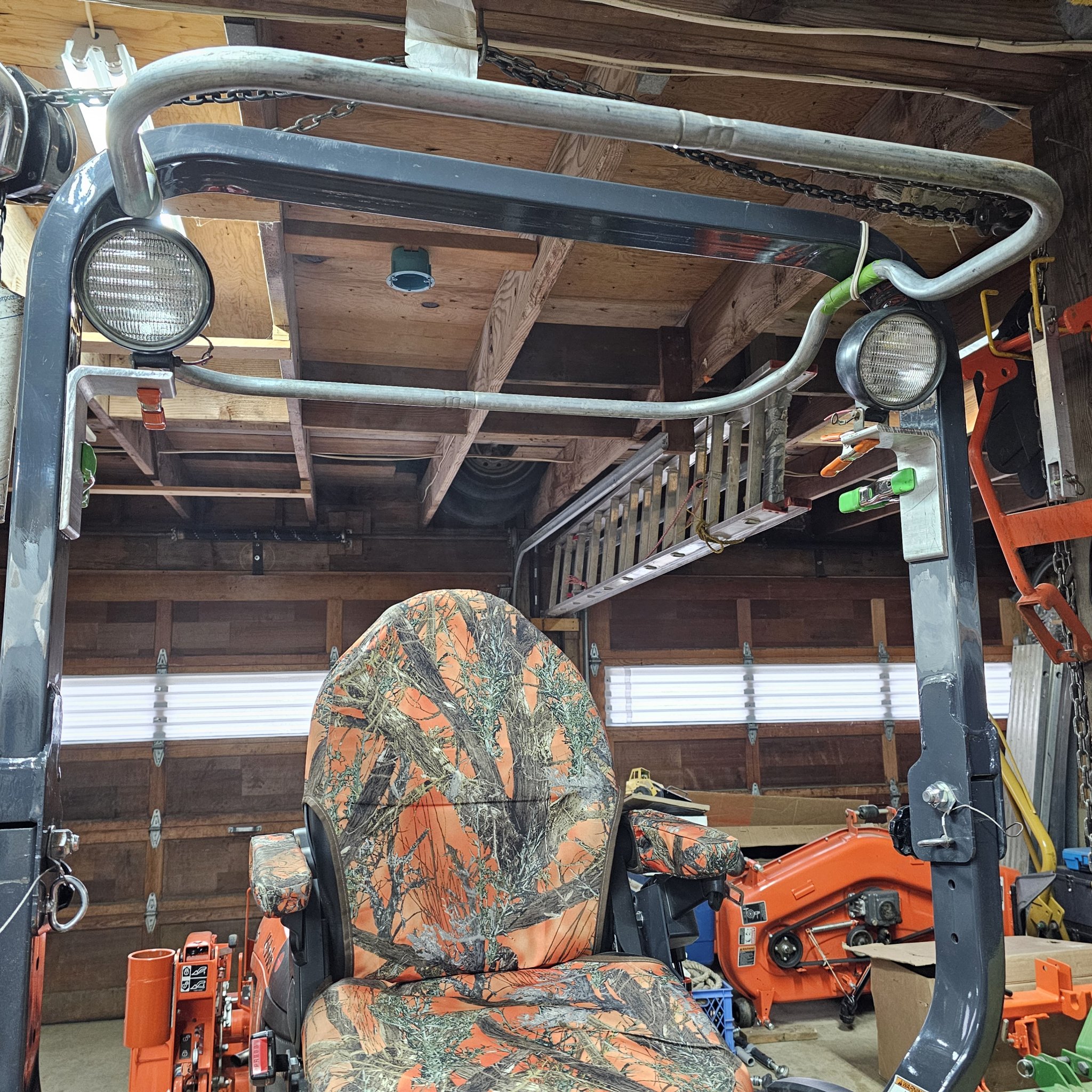

The upper section of the ROP Bar was painted today. *The Kubota Enamel spray paint is nice stuff*
Here's the lights and mounts.

The lights are finally done. I need to pickup and add a couple wire clamps to each side to clean-up the excess wire. D-Rings on the outside of the ROP was an after thought.

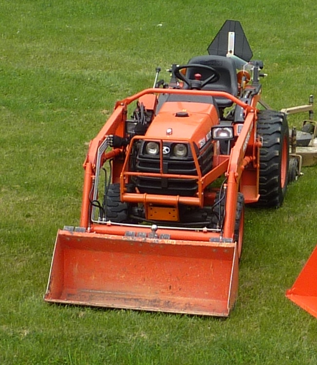

...................Question about wiring the lights: I might as well retain the existing (halogen?) headlights since they do work, even though they're not all that useful with a loader. Where is the best place to connect the wiring for the LEDs? Would the added 36W draw from the LEDs cause a problem if added to the existing headlight circuit?
As you've found, factory headlights are nearly useless. The LED's I use for mowing are mounted low in the grille guard. To power them I disconnected the high beam wires from the headlights and used them for the LED's. Simple twist of the stalk gives either factory low beams or low-mounted LED's (both with tail & marker lights). I do some road travel at night and use the factory low beams for that. Mowing is with the LED's in the grille and loader work is with the high cab-mounted LED's.
