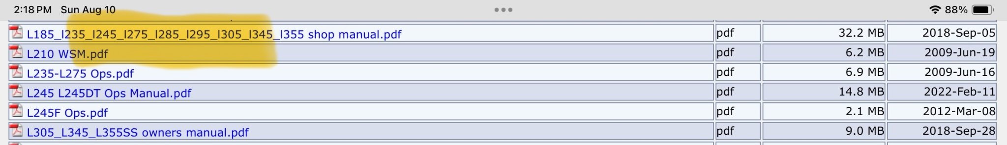

Go to this site and move down to where you see a tractor and click on the tractor
You should see an index like this:
Move to the L185 listings and notice the L245 is in the same WSM as the other L185,L235,L245…
