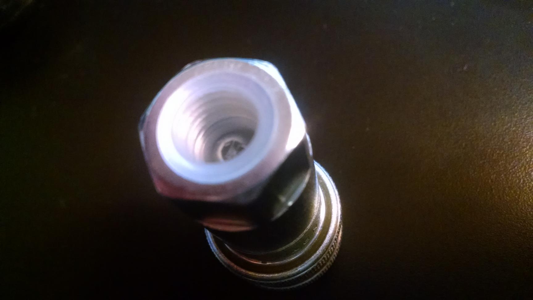

OldeEnglish, thank you so much for the information. One other thing, I'm not sure if you can see it clearly in the attached photo, but there appears to be a plastic insert in the threaded end of the coupling. Question: Does this need to be removed, OR do I screw this onto the hose as is? Thanks again.
