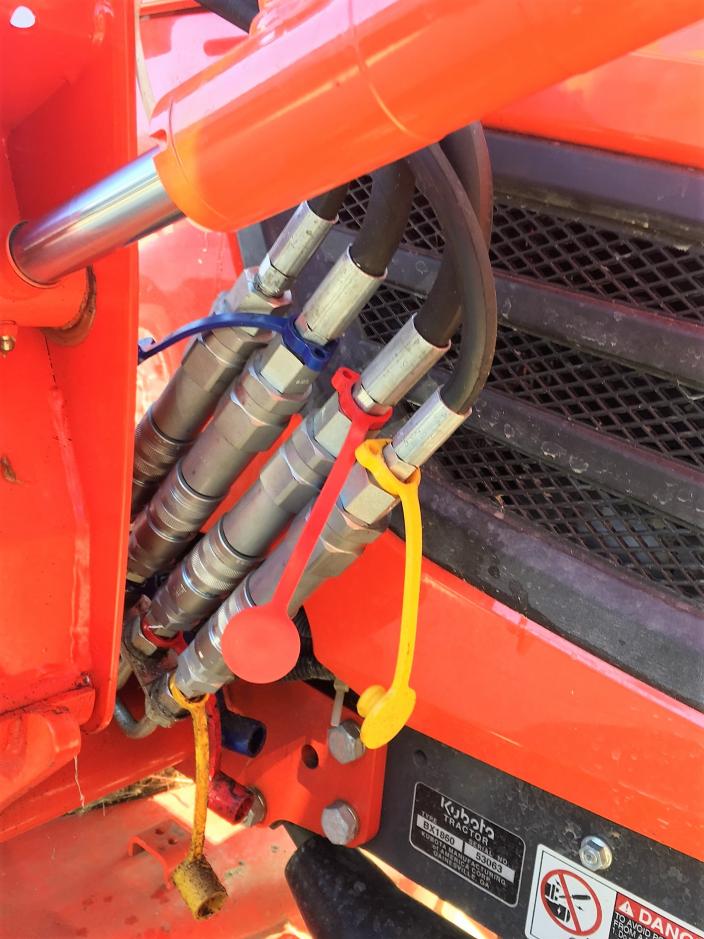

I did not like the oil leaks when connecting and disconnecting the FEL. I also was tired of the struggle to connect when there was residual pressure in the lines of the FEL or snow blade.
Replaces with 3/8 Flat Face couplers. I put the female on the tractor side, and the connect under pressure males on the implement side. Travis set me up with adaptors as well, so everything was bolt on and go.
Contact Travis Adams at Pressure Connections 614-863-6830 t.adams@pressureconnections.com Tell him "H" sent you.
