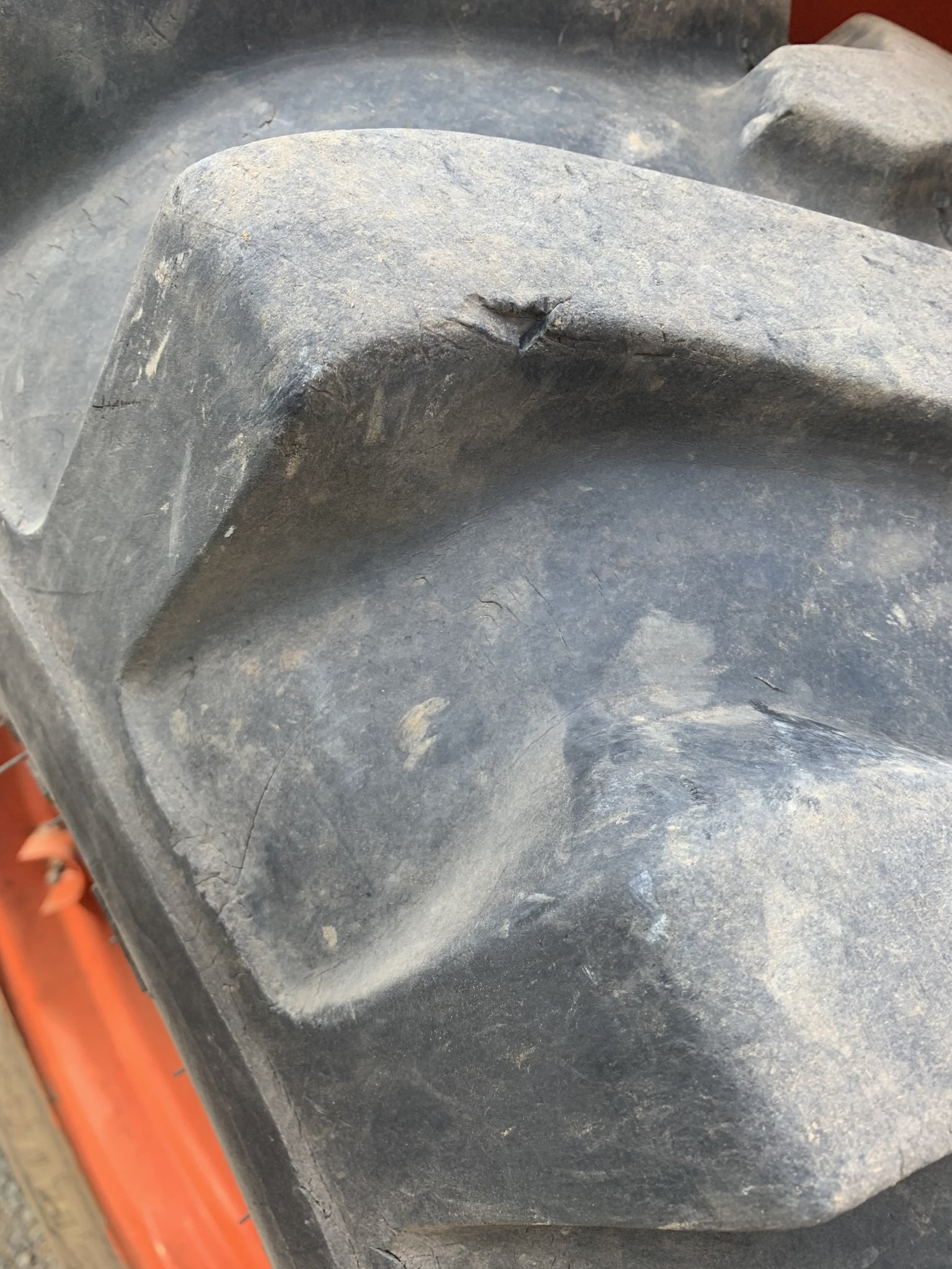

I had to replace the front tires on my L3400 due to sidewall damage.
The dealer said i didn't need to replace the rears and I tend to agree. Any other opinions?
It's 4wd so that's the only concern i have
Rear

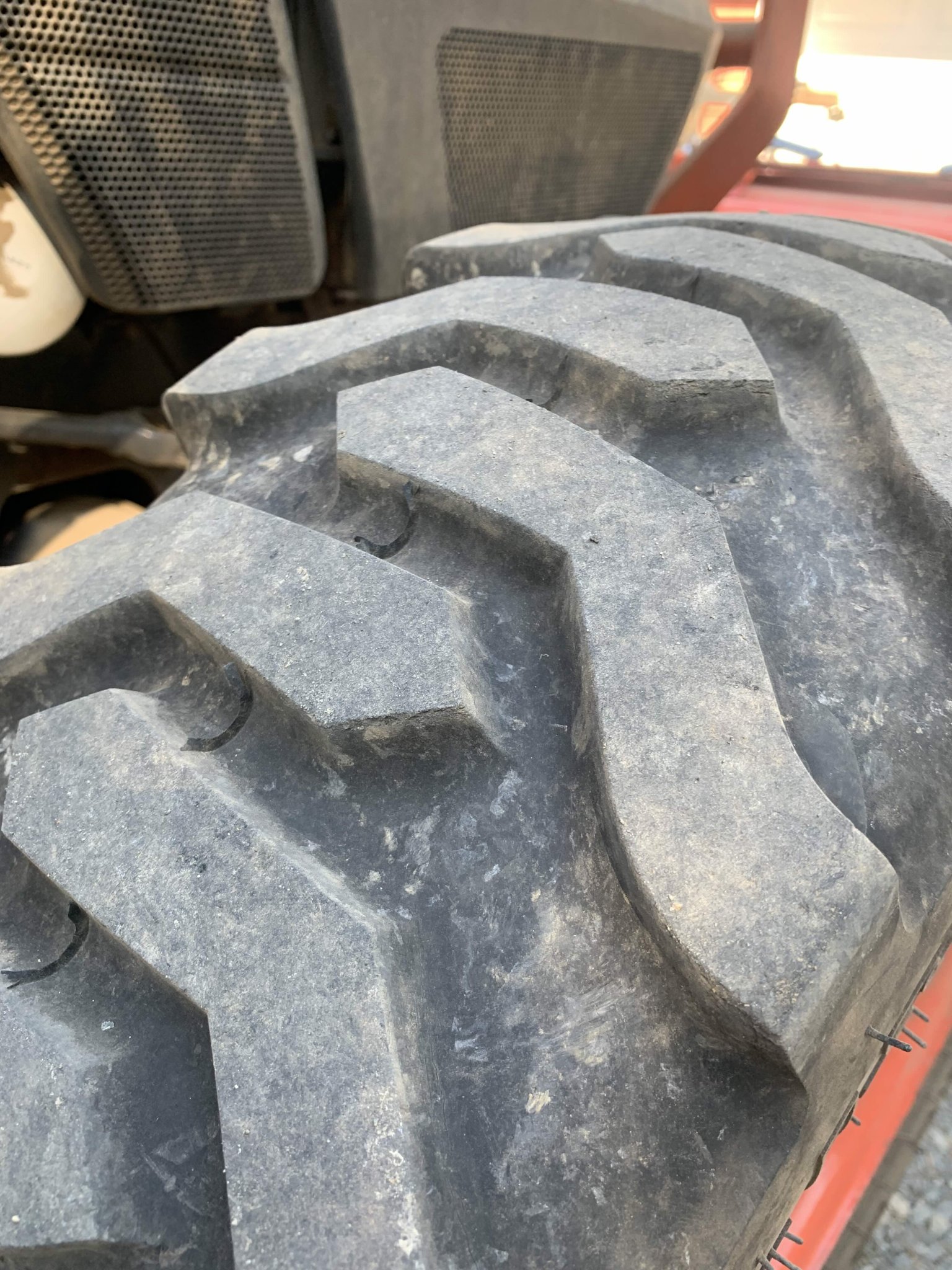

New Fronts

I’d do front only. From all I’ve read, fronts wear faster.

Looks like you're running R1 fronts with R4 rears. I'd be wary of a mismatch in rolling circumference. And, I would check the RCs before running it in 4WD on a hard surface.

Thanks - but its just the camera angle.
Its R4 front and rear but the rears have 800 hours on them.
