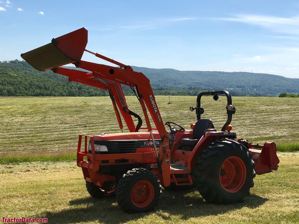

I had to go to TractorData.com to see a photo of your L4310 and to understand how the loader frame is in the way. That does sound like a messed up arrangement. Is there any way to rotate the slots that the screen sits in so that screen pulls out from the top with the hood raised?
How long does it take to unbolt the side frame? Obviously you have a cab since you mention the A/C condenser.

Thank you. I didn't spend time frankly figuring out how to unbolt the support brace because I knew there had to be another way. I like the 007kubotaguy suggestion above, which would save a lot of effort. I will try that.
