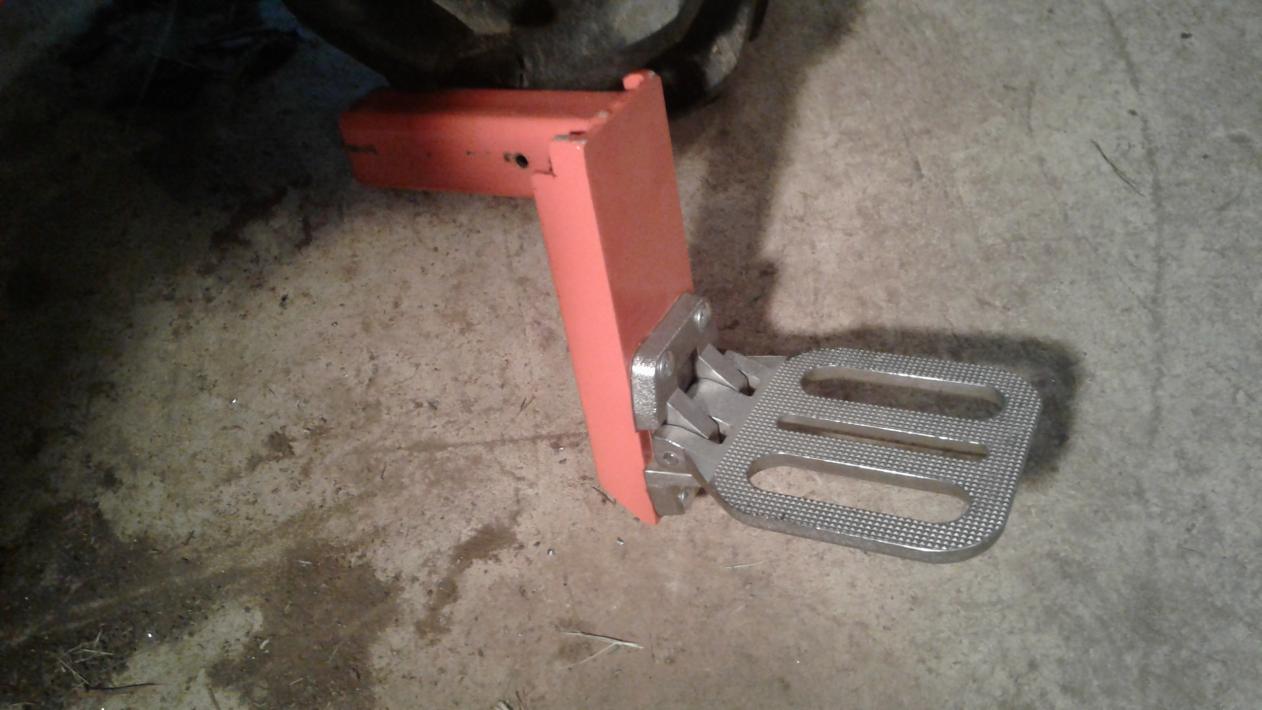

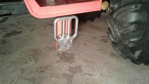

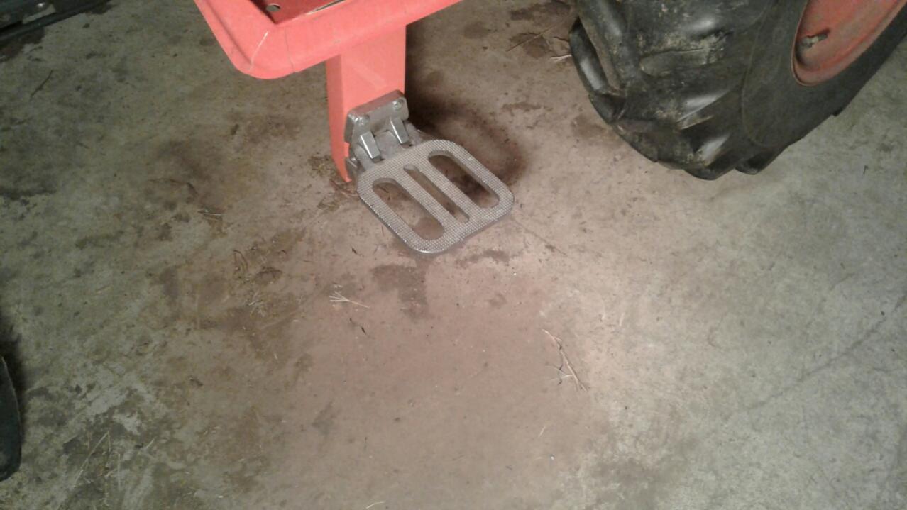

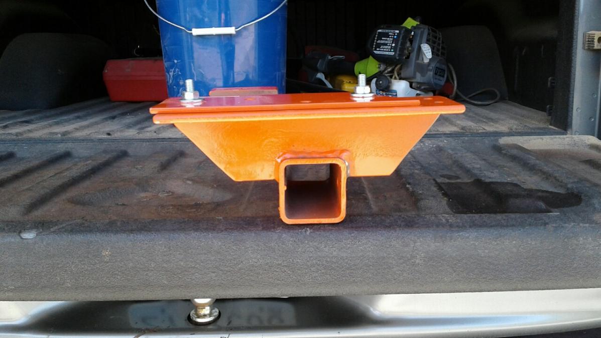

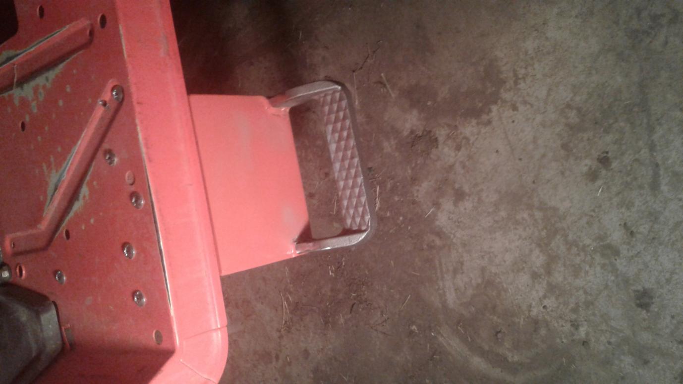

Built a removable step for my B2920. One pin under the platform. One tube inside another like a receiver hitch. Easy on and off around the yard, remove it for rough terrain.
