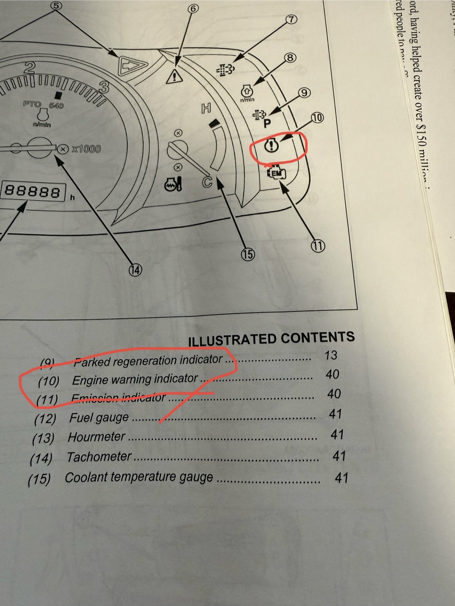

I was spreading dirt for several hours , the air temp very hot, tractor running cool, no other indicator lights on. L3901 sounds good, but the red engine warning light is on. Not sure what to do from here. Thanks.

Tractor not hot and the picture of the warning light in the kubota manual just says Engine warning indicator, no other lights visible, no code. The water temp was in the middle, coolant was fine, oil fine, all reservoirs full, the nest day the light is off and I worked another three hours with no problem

The manual shows the warning like and just calls it engine warning light, no other lights were on, coolant was fine, temp was fine all reservoirs full.
