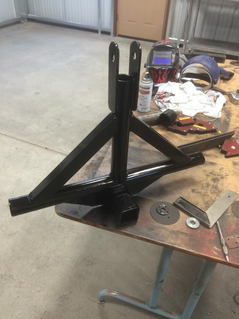

Just took delivery of a 2014 L3301 HST and Mower and I’m new to the forum. Decided that I didn’t want to drive around with the mower attached all the time and when I removed it the hitch arms flop around a lot. I have a utility trailer and decided to build a receiver hitch to pull the trailer and secure the hitch arms.
I used scrap .120 wall 2” pipe, and square stock and TC receiver stock and Cat 1 adjustable draw pins. So about $18 in parts and a few hours labor and the hitch is installed and it works like a charm:).

Welcome to the forum from Alabama. That is a very nice 3pt hitch tow bar.
What would you charge to make one for me?

Thanks mickeyd. lots of them for sale on line on ebay so and I don't want to get into that market. If you were in AZ, I'd just have you come over and we would knock one out in my work shop.

Welcome aboard from a fellow Az dweller. Nice fab skills, and, judging from the pic, that is one nice, clean, low hours Kubota!
