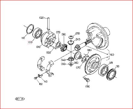

And for part #'s you can go to Kubota.com under illustrated parts.

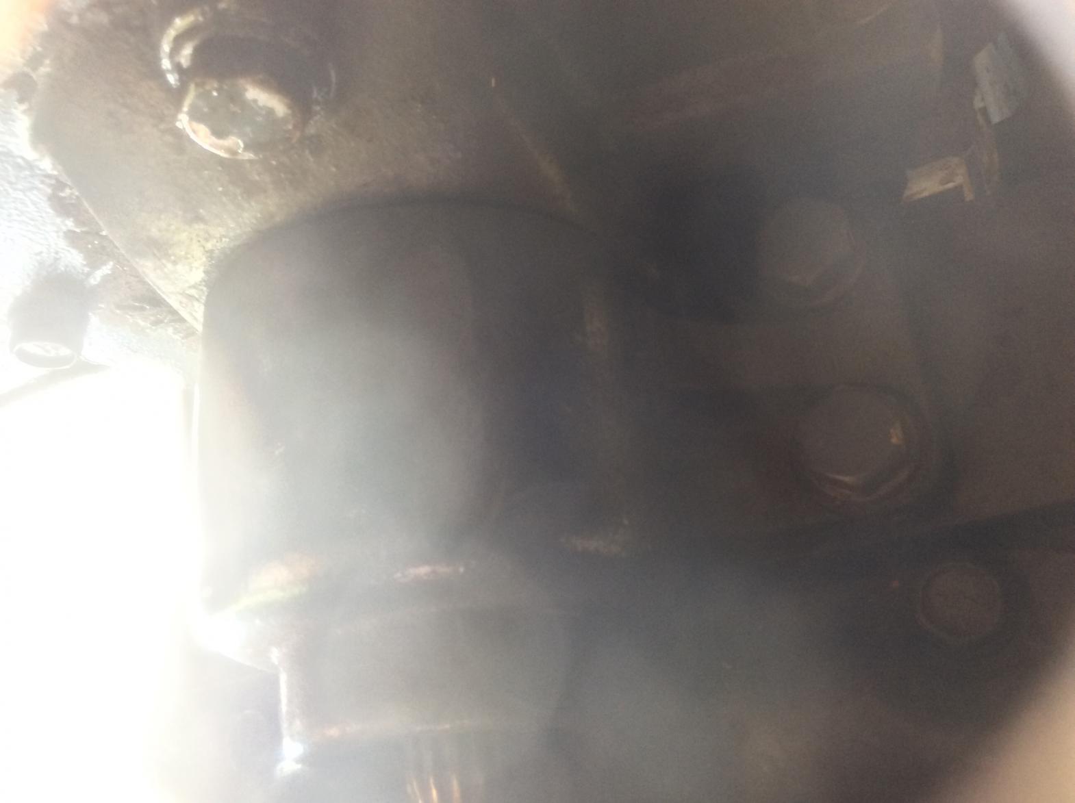

I'm in the process of removing the pinion bearing case and differential assembly as a unit from the front axle case. Does anyone have any techniques for separating the Pinion Bearing Case from the front axle case? I'm only been able to move it 1/4 of an inch. :mad: It's kicking my behind.

North Idaho Wolfman - Thank you for your assistance VERY MUCH. If you're ever in FL - I'll buy you a beer. I'm removing now as I figured out the WSM is progressive on separating. Some days you're the windshield, somedays you're the bug. Yesterday I was the bug. :D
I'm trying to figure out how to drop bevel case off of the axel case. I have all the bolts out and disconnected the arms. I'm going to try sliding a stiff putty knife to separate the cases.
