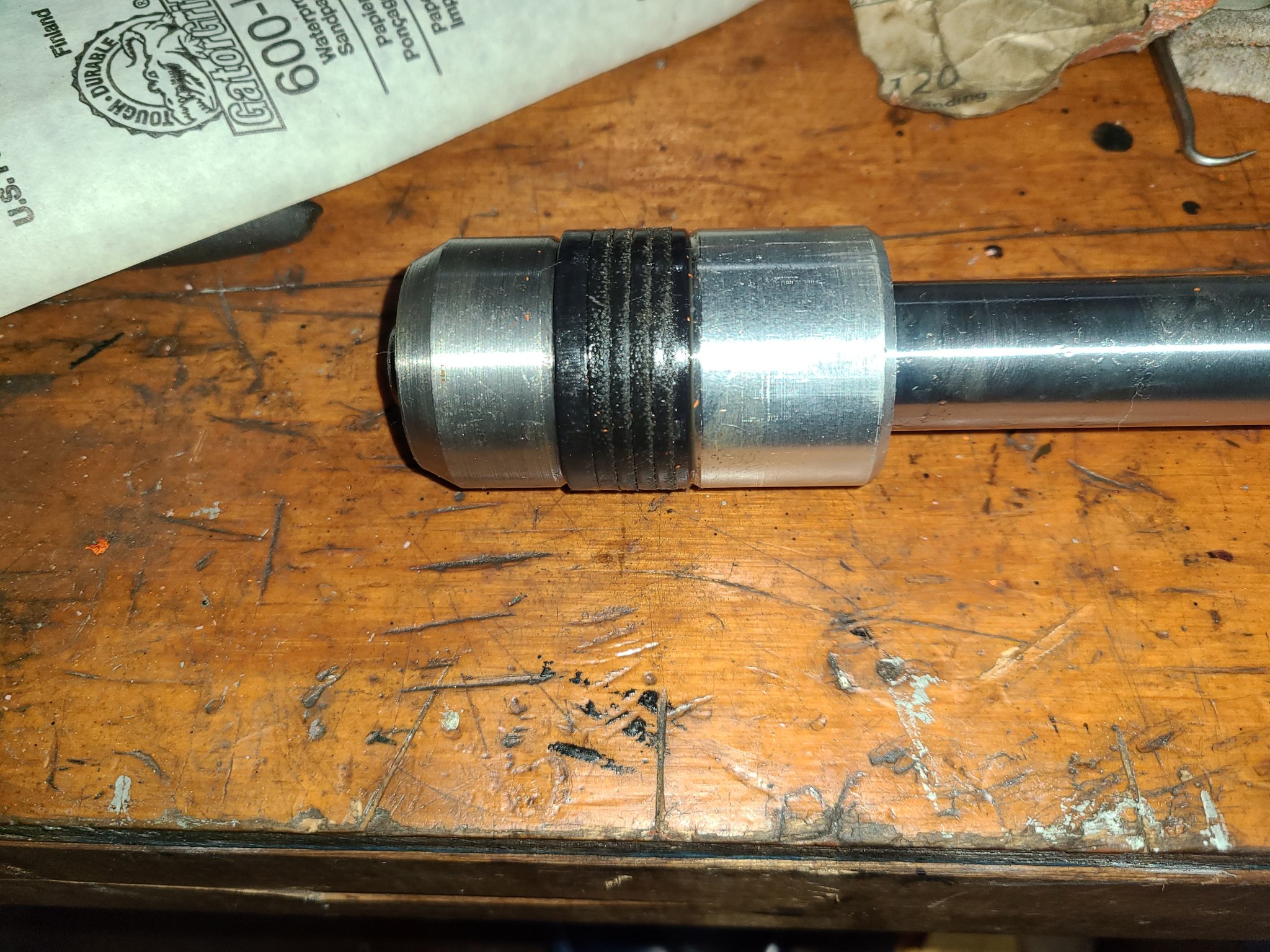

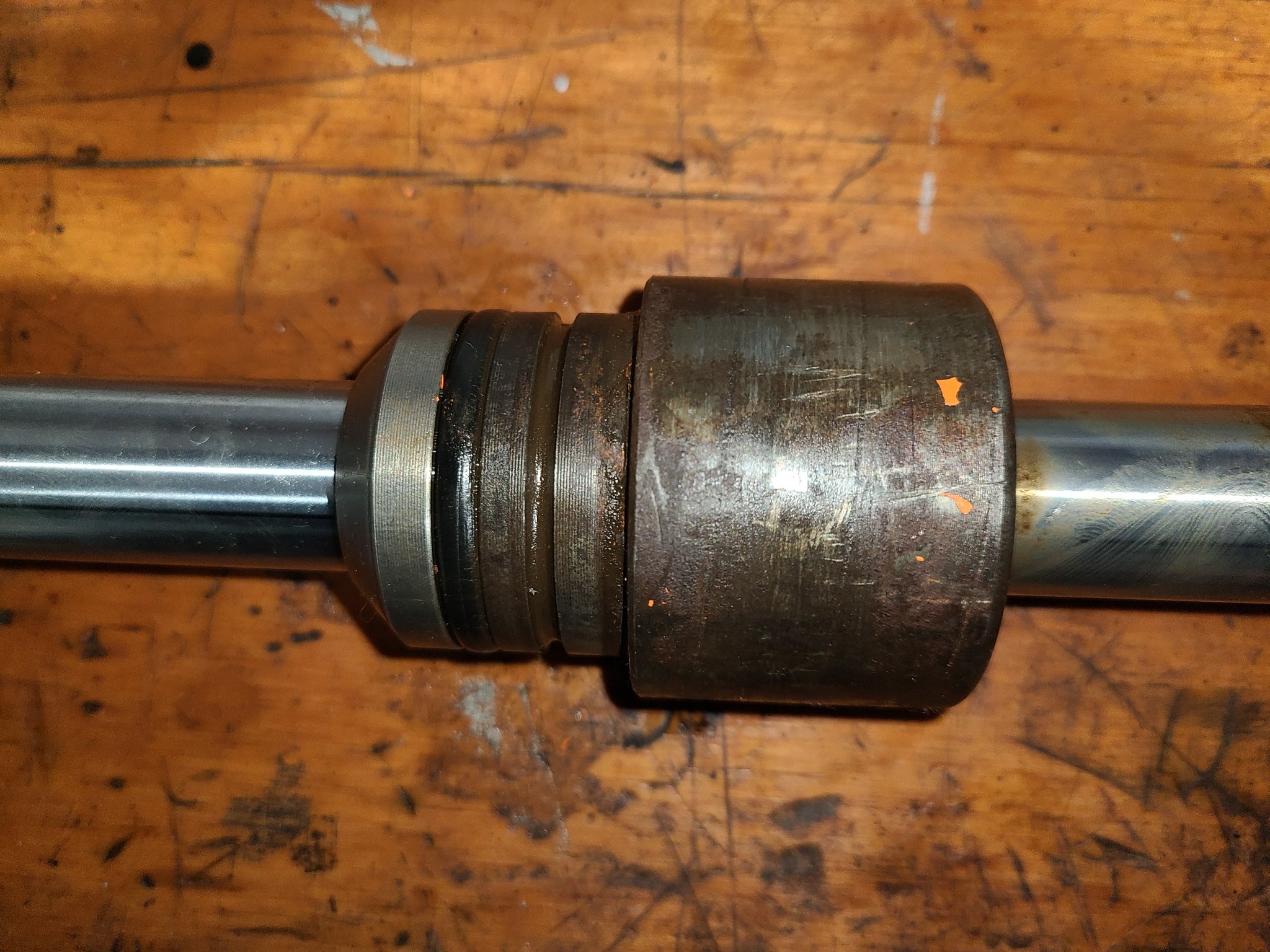

Thank you for the links. Unfortunately I dont think those apply to my cylinders. As you can see in my picture above the piston nut is not a typical nut - it is round and a spanner wrench is required. I would think It would be difficult to get 200-300 ft lbs on a spanner wrench with a 10" long handle.....kinda at a loss on this.
The fact that it requires a spanner wrench leads me to believe there isnt a specified torque. But I really hate assuming.

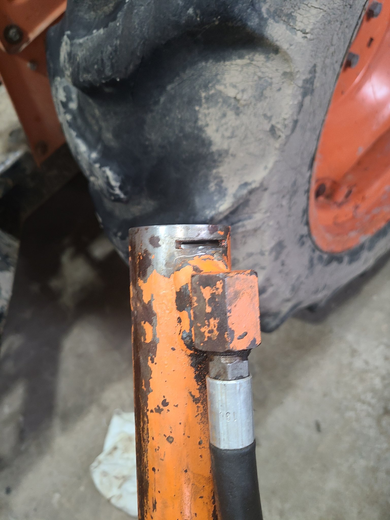

Also the gland nut at the top, the one that is typically tighter than hades is not even threaded at all. It simply has a 1/8" rod that laces through the barrel around a groove in the gland for retention. I have done a few of these cylinders in the past, this style is a first for me.
Slot in barrel....
This 1/8 keeper threads through the slot in the barrel and arround a groove in the Gland assy... notice the lack of threads

The ID of the seals are 1-1/8. The nut is 2". The nut also just slightly compresses the packing before it bottoms out on the piston.
