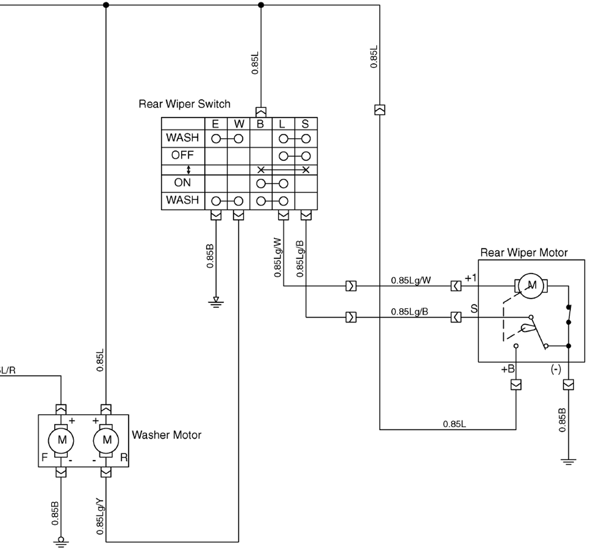

This is the wiper wiring schematic for my M6060 so take that for what it's worth. It shows a 15A circuit, and when the switch is turned ON there's 12V provided to a relay in the wiper motor via the Light Green & White (Lg/W) wire. When the relay trips it connects the + side of the motor to the Blue (L) wire which is the 15A source, and the - side has a direct path to ground with the Light Green & Black (Lg/B) open circuited by the relay. Well, that's how it looks to me. A multi-meter is your friend in these situations.
