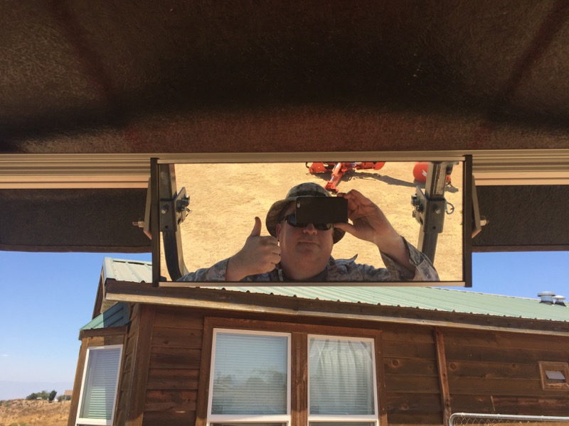

This weekend, I added a big rear-view mirror to my L3301HST. It has the M-series deluxe fiberglass canopy. The dealer accidentally installed the M-series canopy instead of the normal L-series one. They liked it so much that they decided to quit ordering the L-series canopies and just use M-series ones in the future.

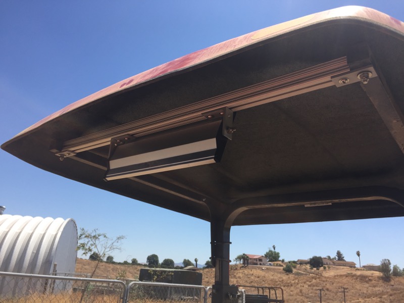

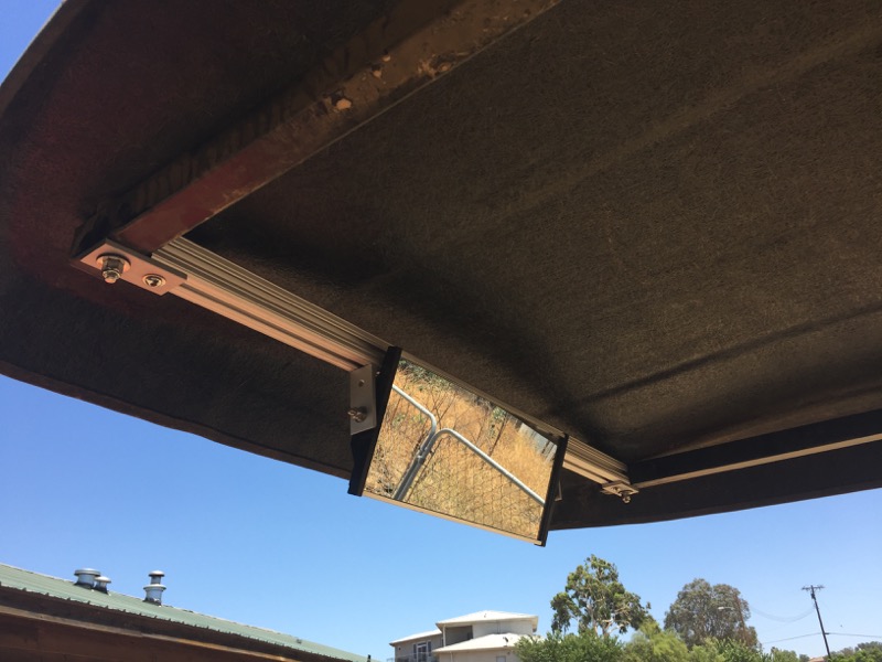

I used a big "west coast" semi truck side mirror, rotated 90 degrees. It's mounted on 1.5" 80/20 extrusion, hanging from the front canopy mounting bolts. I plan to add some LED work lights on the same extrusion later.
It makes a bit of a head hazard when getting on/off the tractor, but it sure saves a lot of strain on my neck and back. The mirror and all of the hardware came from McMaster-Carr. I also wrote up a blog post, but it doesn't have much more detail than this forum post.
