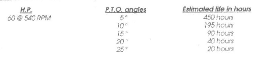

One issue to consider when making a blower purchase involves the angle the pto shaft joints will be running at when blowing snow.
A pto joint running at a 25 degree angle has a design life expectancy of 20 hours while one running at 5 degrees has a life of 450+ hours.
A lot of this calculation involves the diameter of the blower's fan. If the fan is listed as being 18" in diameter then its middle where the pto shaft engages will be 1/2 the fan diameter or 9" above the ground.
You can easily measure how high your pto shaft is above the ground. Keeping these two numbers as close as possible will ensure your pto joint angles will be as low as possible.
