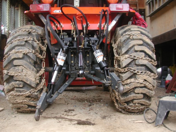

I agree, 3 is a good number. I'd like to see pictures of yours, why 2 tilt cylinders?
My B2910 is not a large tractor. With one tilt cylinder I would have lost 3PH lift.
With two cylinders I was able to gain a little extra 3PH lift, and an added advantage with both cylinders fully up or down I could be sure the implement was level at those points. With one tilt cylinder you take your best guess as far as level goes. As I do between the extreme points.
I put the setup together myself, so had maximum flexibility.
Looks like this:
(Cylinders are 4” stroke)

That’s wild! Are the 3 point arms all the way down in this picture? Then lowering the tilt gives you that much more?
I believe the arms are all the way down in the photo.
By using two cylinders I also get a little more lift than possible with the standard set up.
Another advantage is I know the implement is level if I have both cylinders either full out or full in.
