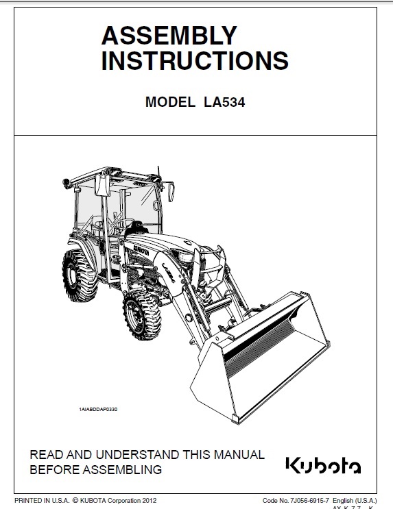

This is the cover of the sort of assembly instruction manual you need to properly install a loader. The Workshop manual is lacking the important details.
A dealer should be able to provide a pdf copy.
Are you using the INSERT IMAGE tool icon at the top of each post screen?
The forum will re size down an image to fit but if it has little info to start with.............

Thank you for all the help. I will look for that particular manual. I think I figured the pictures out the second time. I suppose the cheapest and simplest option would just me to have long hoses made for the loader and plug them into the rear remotes but it just would be nice to have it the right way
