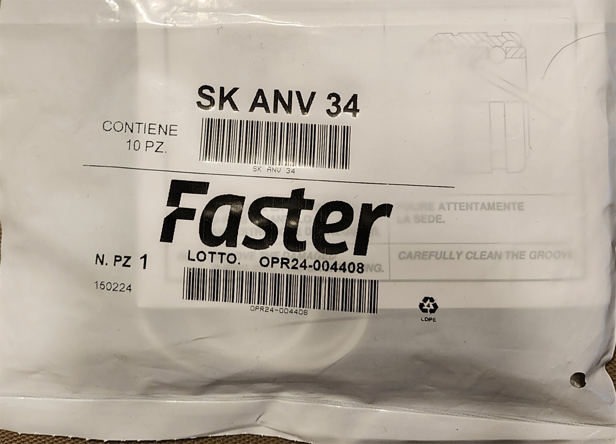

I ordered and received a seal kit for the Faster couplings on my M6060 due to leaks.

Seen your post earlier about that. Where did you order those from? On faster couplings website it shows that part number is for 3/4” couplings?

I ordered from the following company after speaking directly with Faster customer service and giving all of the information I could find on the couplers. The person I spoke to told me that SK ANV 34 was the seal kit that I needed.

If you call, it's best to have the part number of the seal kit that you want. The guy I spoke to wasn't overly interested in doing research, so he was pleased when I told him that I knew the part number.
I haven't replaced any seals yet but based on the tool marks on the couplers on my tractor, someone screwed them in place using a pipe wrench. To be honest, the couplers look nice and the dust caps are nice too, but the website sucks, the numbering on the couplers sucks, having to use a pipe wrench sucks and so on. Overall I'm quite underwhelmed and actually annoyed by most everything about Faster as a company.

It's entirely possible that the seal kit I have isn't the right one, but the woman on the phone seemed to know her stuff and was quick to tell me what I needed.

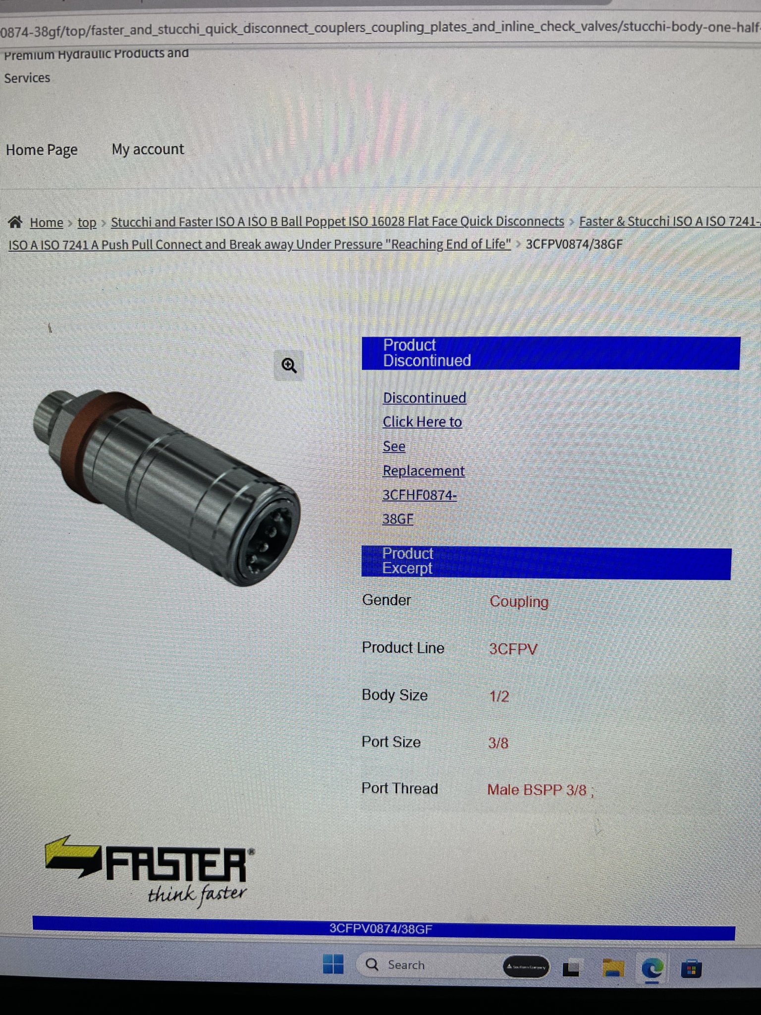

Need to know exactly what you have. Part number should be stamped on the coupler. I thimk the original has been superceded.
The male end that threads into the tractor has Faster 74/380 20N1.
Next piece has Faster 3CFPV-4SFPV 21AO.
Female end has Faster 3CFPV F-21BO.

The 3CFPV is obsolete and replaced by 4SRHF. I dont recognize the 21B0 thread type. Dont the female couplers screw directly into the valve on the tractor??
No the male end 3/8 BSPP goes into the valve block on the tractor.

Yes, the female coupler has a male thread end with o-ring that screws directly into the work ports on the valves. If you are certain the thread is 3/8 BSPP Valpariso will be the best price on the new 4SRHF replacement. I pay $35 for the female ORB version and use a male to male adapter to make the gender change.
