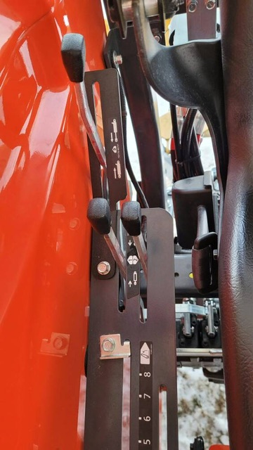

I added 2nd and 3rd positions on my MX. It already had the first installed from dealer. It’s not hard, just a bit space constrained!
Valve stack.
Hoses
Levers
Then I added top and tilt cylinders from @MtnViewRanch.
If you are doing one, might as well do 2 or all 3. They open up more options.

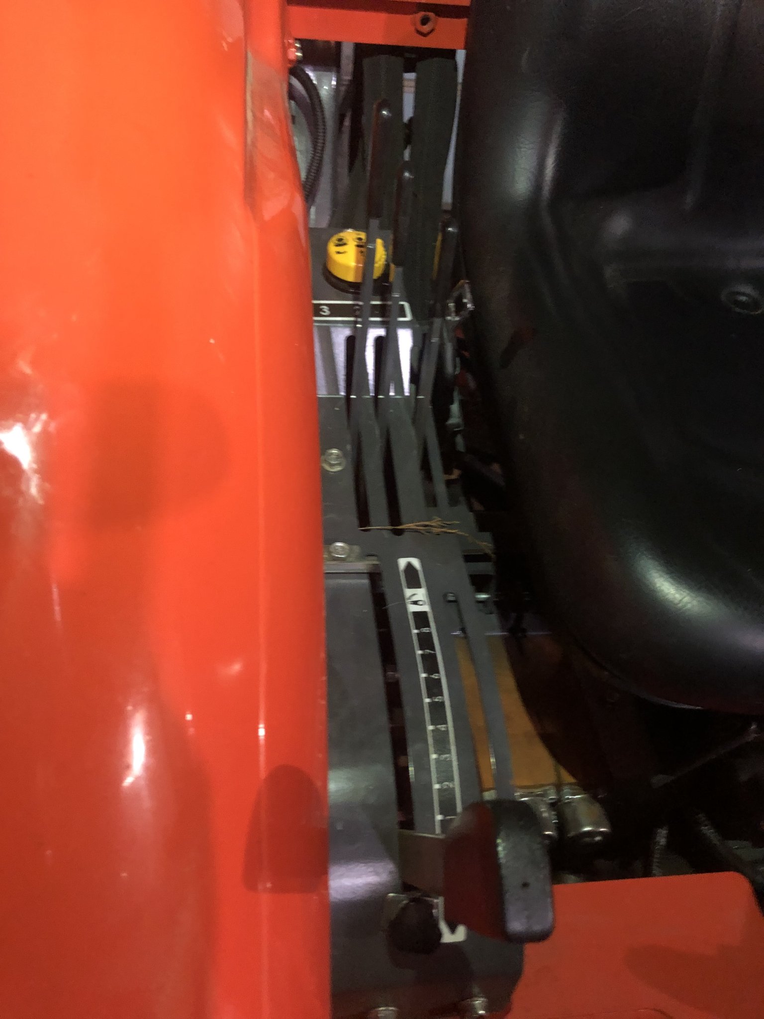

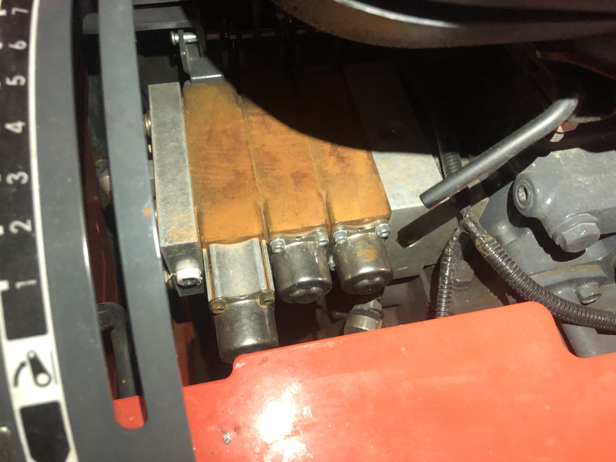

I have three OEM rear remotes on my L4701; 2 spring center and one float. They rear remotes and hydraulic top/side link are the only things I would have changed in my initial purchase order if I could redo it.
I had reasons for wanting float and have no regrets but if you don’t want/need float and want a hydraulic top and/or sidelink I’d suggest getting the check valved cylinders so any internal valve leakage is irrelevant. Yes, I reach over and bump the side link once in a while to level it up. The valve that runs the toplink has negligible leakage from an operational perspective so no routine checking/adjustment needed.
First position MUST be spring return. Valve with float detent or continuous flow detent is physically larger than spring return and won’t fit in first position. Any of the three types will fit in second and third position.
Worst part of the job is removing the right rear wheel. Mine has filled R4’s and the ballast is over 500lb so the wheel/tire assembly is 500lb plus whatever the wheel and tire weigh without ballast. Not something to be dealt with without some planning. I had dealer install mine. By far the most expensive route. Advantage was I dropped it off one afternoon and picked up the next.

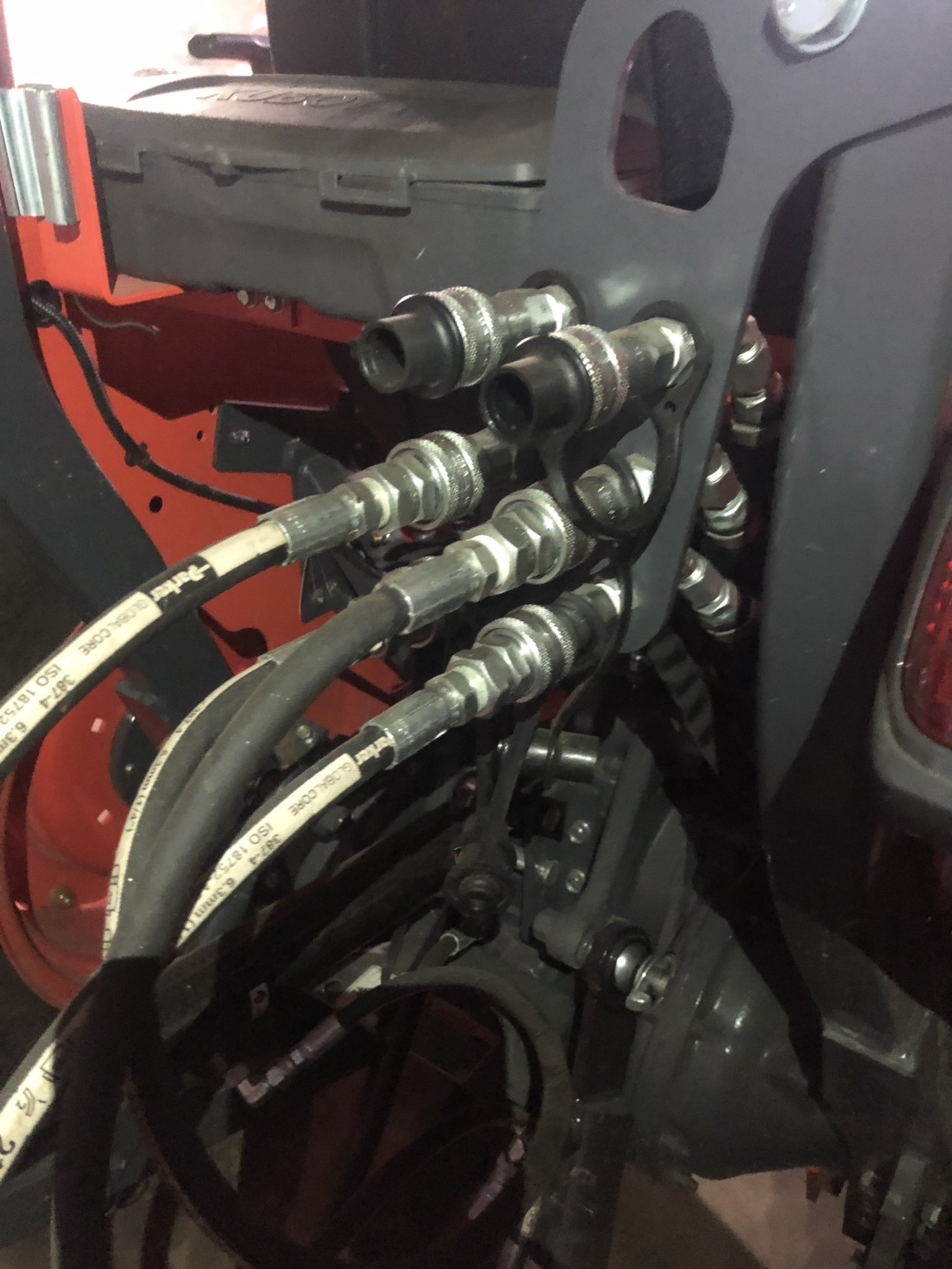

Not advocating for OEM, but just FYI this is what three dealer installed OEM remotes look like on my L4701. The bigger one in third position (nearest the fender) is the float detent valve. The silver block to the right of the valves (the three rusty looking things) is the base that’s required whether you add one, two, or three valves. Having the three handles all different lengths assists in picking the correct valve by feel rather than having to look at them.
9,244
4,821
Not advocating for OEM, but just FYI this is what three dealer installed OEM remotes look like on my L4701. The bigger one in third position (nearest the fender) is the float detent valve. The silver block to the right of the valves (the three rusty looking things) is the base that’s required whether you add one, two, or three valves. Having the three handles all different lengths assists in picking the correct valve by feel rather than having to look at them. View attachment 129741 View attachment 129742 View attachment 129743
Now I believe that is the old style kit with the valves mountrd horizontally. . Same setup as used on the smaller L01s.
New style has a different manifold with valves positioned vertically and comes with the stackable push-pull coupler blocks shown below. Basically the same as used on the Grand L's and bigger machines.

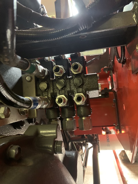

I added two rear remotes on my B2650, which is quite different than what you have for space. It works well and is all out of the way, just below my right butt cheek. Levers come forward right next to the seat.
Another idea if you’re not going to be using the rear remotes much, and don’t need your loader while using the rears, would be to run lines to your loader valve for the occasional rear use.
A compromise would be to install a diverted valve on your loader lines so you can quickly switch from front to rear.
