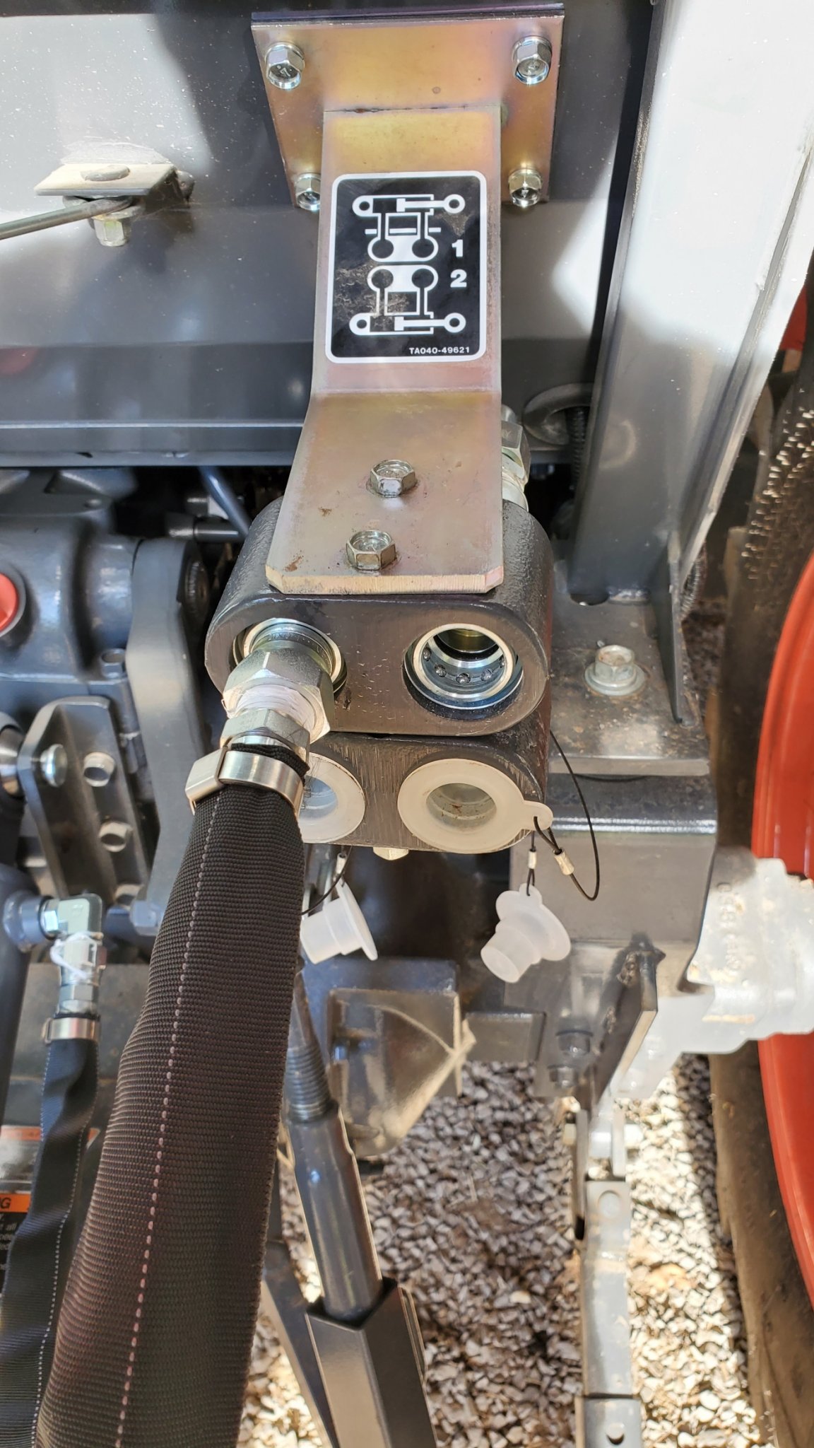

Have OEM rear remotes installed by Kubota dealer. Currently installing my Top n' tilt but when trying to connect the hoses to the rear remote fittings, it seems as if the sleeve on the hydraulic line at the remote needs to be slid backwards such that you can then insert the line coming from the top cylinder (or the other lines as well). Is there a trick to getting that sleeve to retract so that I can insert the hydraulic line? It seems the only way is to push on the back side of the rear remote line but I'm guessing I'm doing something stupid...any suggestions?
Thanks!

Make sure your tractor is off and the pressure relieved from the system.
You should be able to push them right in and pull them out - if the hydraulic pressure is relieved.

Pretty sure I did relieve all of the pressure - but going to confirm that there is no pressure on the TnT cylinder side and give it another go today. Thanks!

Push pull works. You can also pull and it will pop out - Even under pressure. There isn't a collar to retract on this style of pioneer coupling.
Keep a clean rag handy these connectors tend to squirt out and drip onto your tractor and the ground.
I probably don't need to says this but make sure both male and female ends are clean before re-connecting. Keep the dust covers on when disconnected as the female ends are dirt magnets.

Relieve pressure on the TNT cylinder via the coupler (couple of crescent wrenches, etc) then report back.

Your remotes may be a fancier version of this
These clamp on the sliding collar, if a drawbar implement disconnects the hoses are pulled rearward and couplers release.
To connect hoses, pull the mounted hose rearward (releases the locking bearings) and push male fitting in and release the mounted hose

I find that I have to push them in and then hold the pipe at the back of the coupler to get them out

Thanks everyone for your comments - I did get it to work and it was simply as someone mentioned - push them straight in and they will click. It didn't feel right when I first did it that way, but yes that does work.

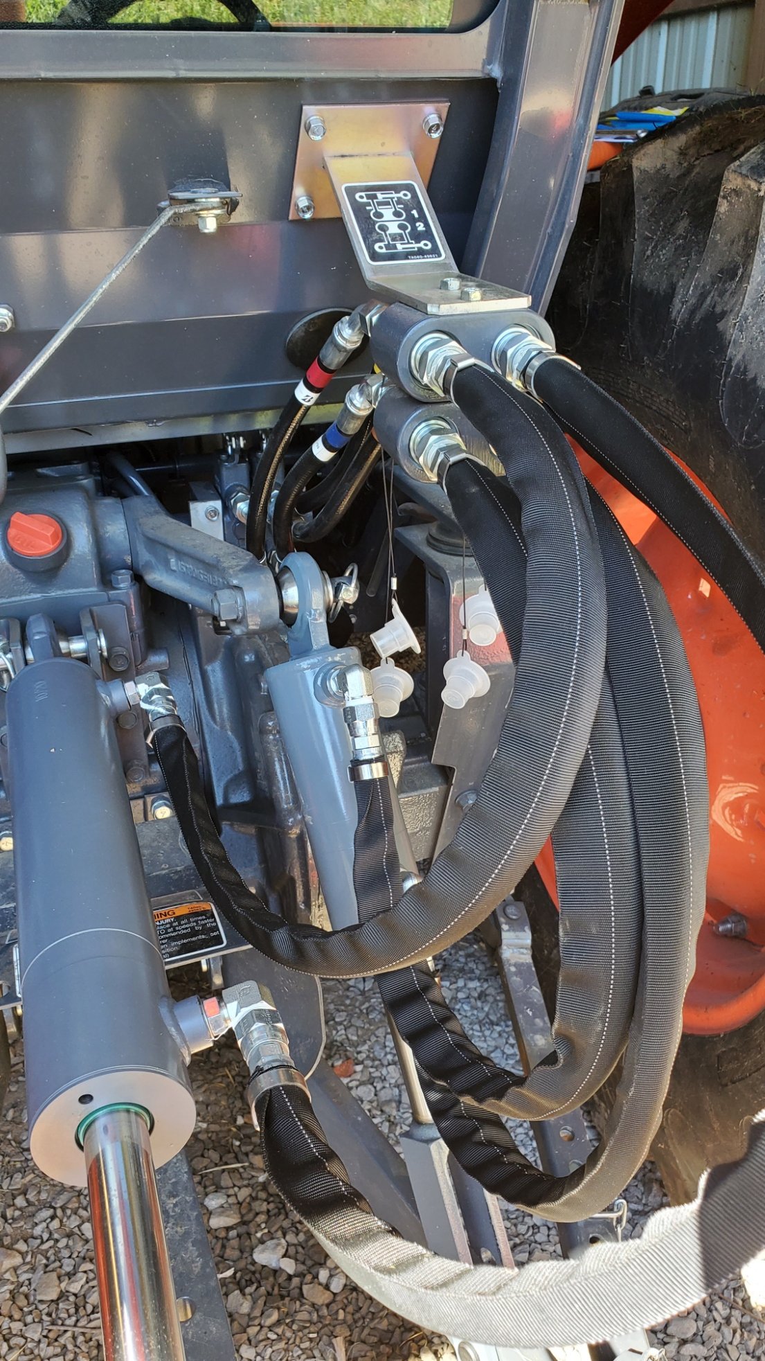

So that works now but I have a separate issue - when I use the tilt function the side with the cylinder on it will tilt up but nothing passed basically being level. So I can tilt the cylinder side up, but not down. It seems like the cylinder is the wrong size, but I purchased the kit from a kubota dealer and the dealer said it is the correct one for my tractor.

There are more than one mount holes on the bottom of the cylinder. The three point arm my also have different positions. The positions work like this: One end gives more range but less lift, and vise versa.
The top tilt should be adjusted so the tilt cylinder is in the middle of its range vs the left arm. Your actual raise and lower of the whole assembly is done with the 3 point lever.
