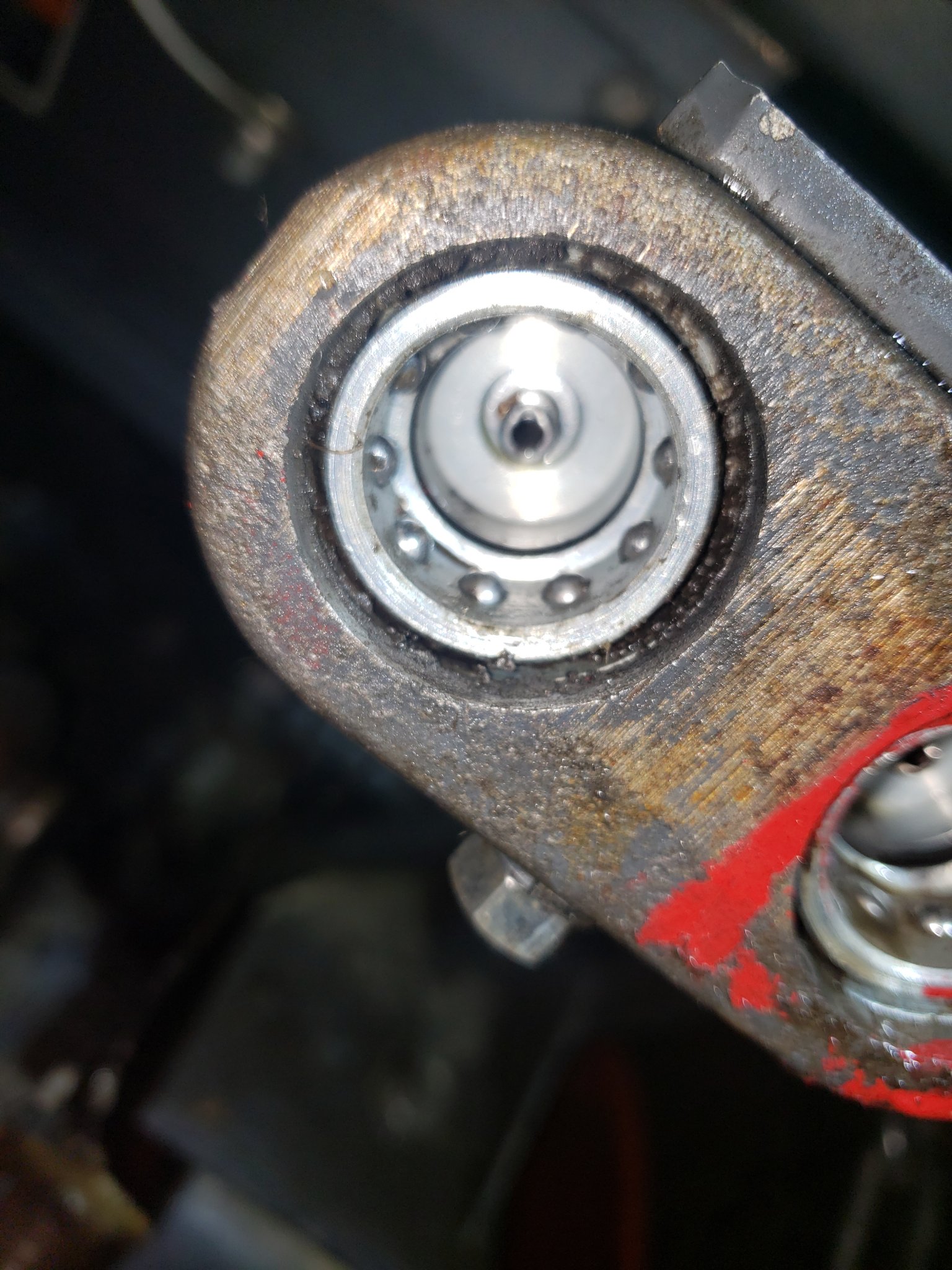

My L5740 has a set of rear remotes, what type of male connectors do I need to work with them?
1/2" Agricultural quick coupler male tips - aka ISO 5675.

from what I saw at the hydraulic sites there are two types; a ball end or poppet style
which style do I need?

Poppet vslve is supposed to open a littlecwider and flow a little better. Your outlets are poppet style but will work wit either. Personally I try to use poppet style if possible.

hmmm thats weird they gave me the ball style but the they wont lock in
A lot of people have trouble when they first encounter those outlets.
Those outlets are one hand operation.
Push the tip in and simply let go - it will automagically lock.
Once locked if you pull on the tip or hose it will automagically release. That's by design and is a feature called break away protection.
