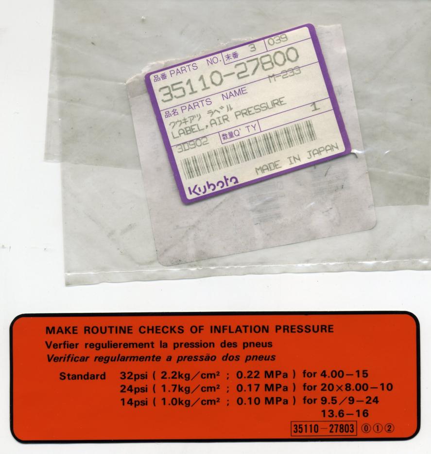

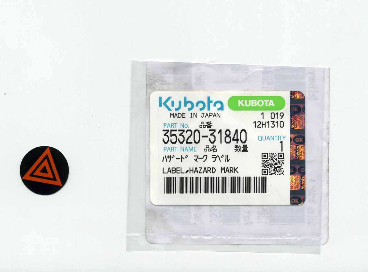

Russell, I wonder if you can help, I for the life of me
can not figure out where these two labels are supposed to go....
Russell King said:
Bill,
Your pictures did not come through so I don't know which two you are having trouble with.
Try one at a time or post in the thread and I will be happy to try and help
Russell
Here are the photos again............

The Hazard decal goes below or beside the hazard light switch. Tire pressure decal, I am coming up blank on.
6,954
2,433
Re: Scans Of 185 Labels
I assume whitetiger is correct. All I can see on the 35320-31840 is it is on the dash near a switch. Makes sense that it is the hazard switch if you have one. I don't have any of the hazard lights or switch on my tractor.
The other label 35110-27800 (or 35110-27803) goes on the right hand fender top. There are three labels that are there. A larger label (35110-34910) for safe operations, a smaller label (35110-34930) that is also safe operations and then this label (35110-27800).
The large label is by itself and the other two are stacked one over the other placed to the right of the large label. The air pressure below the 35110-34930.
Sort of like this:
---------------35110-34930
35110-34910
---------------35110-27800

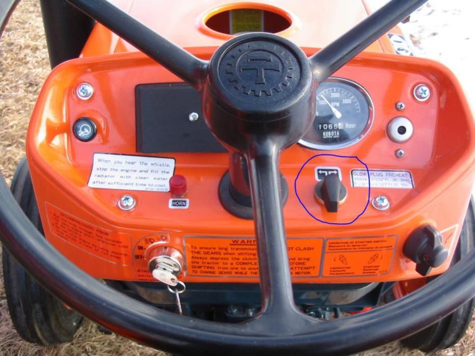

Hello, Bill!
I am wondering where you got the turn signal knob and screws.
Well actually that's not a picture of my Dash,
that's just an example of what the label should
look like. But I do have the knob and those screws,
the knob was on the tractor when I bought it,
and the screws I just got at the local hardware store.
Just standard metric hardware,
Unfortunately they did not have them in stainless
steel like most everything else I used. I'm sure I
could find them in stainless on line though.
:):):) I thought the tractor in the picture was yours because
I went through your facebook site and saw your tractor looks like almost brand new.
Thank you anyway.
have wonderful day
Jkk
