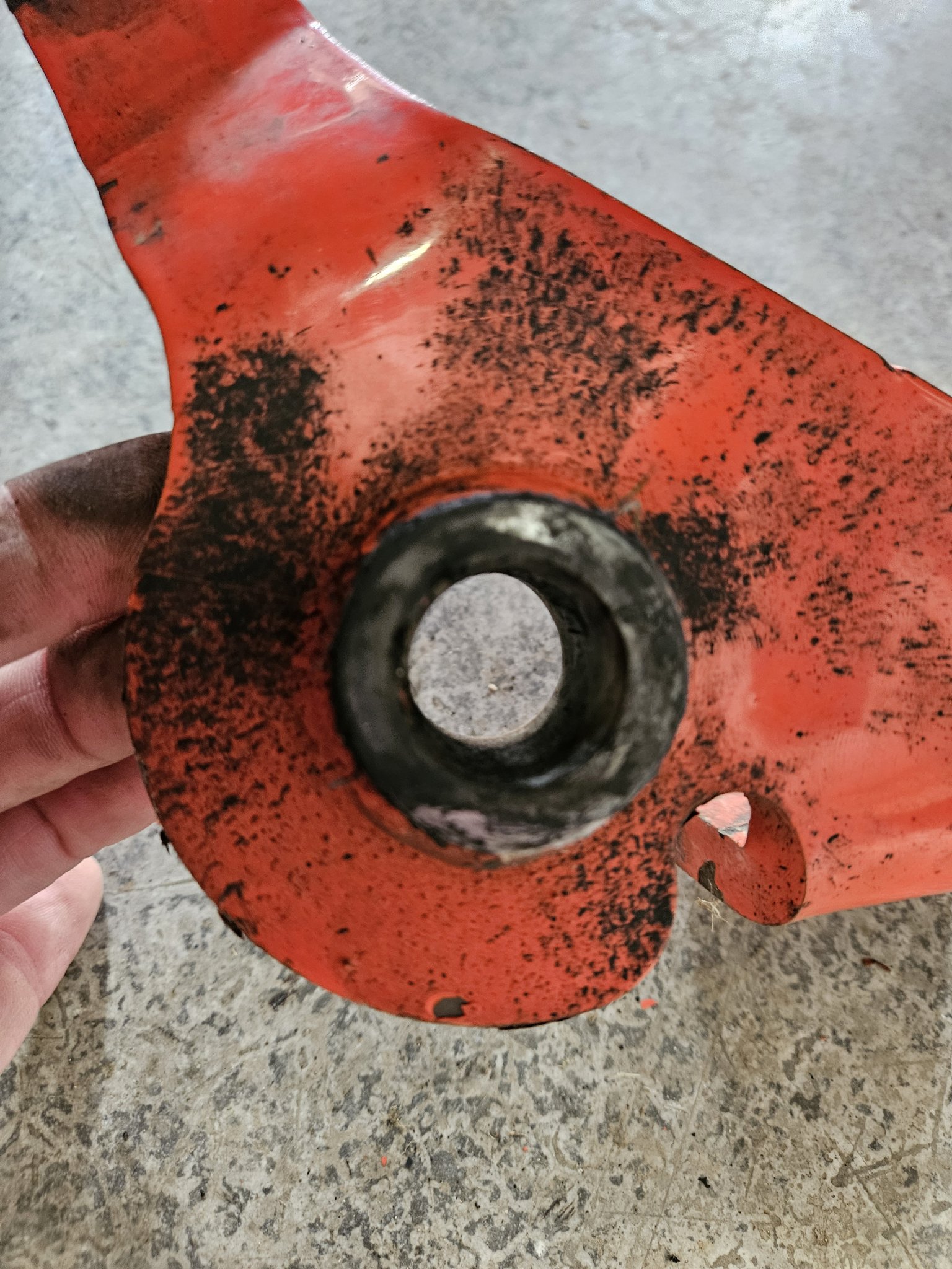

Thank you for the assistance. I added three videos to give you an idea of what I am looking at. I do believe the lift arm is not true. However, there is no way to tell as the entire piece is different angles. I did use a set of mics on the inside and outside and the are identical.
I pulled the lower center link pin and rolled it on a flat surface thinking maybe it was bent. It rolled perfectly. I think the video does show the connecting rod pull slightly to the left when raised and I think it is enough to cause my issues as it does not allow the control knob to turn properly as it is not straight up and down and meeting the lower can squarely.
I guess my question is which part needs replaced to stop the yaw when lifting. The rear three point arm also has a deep gouge in it from hydraulic pressure which could cause it also but that damn part is almost $400.00. The lift arm is at least cheaper at $78.00.
