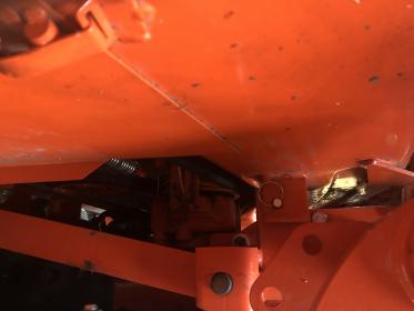

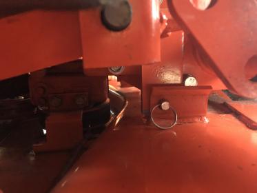

The MMM has brackets into which pins can be installed to lock the MMM in the fully lifted position enabling the three point lift to be lowered for other reasons without lowering the MMM. The "mid: brackets have brackets with holes into which these pins can be installed. Unfortunately, the holes in the "mid" brackets that I have are about 3" too far forward to align with the corresponding holes in the MMM brackets.
It is unclear to me if there are different "mid" MMM brackets for use with B series tractors of different vintages (I may not have the correct ones.) or if I need different FEL brackets for the 3350 (not a viable option) that have integral "mid" MMM brackets with compatible brackets with holes for the RC72-30B.
This is an obscure question, folks, but I'm hoping that someone with a FEL equipped B3350 or 2650 with a 72" MMM might be able to post photos of the "mid" MMM brackets with the MMM in the fully lifted position showing how the lift lock pins are installed.
