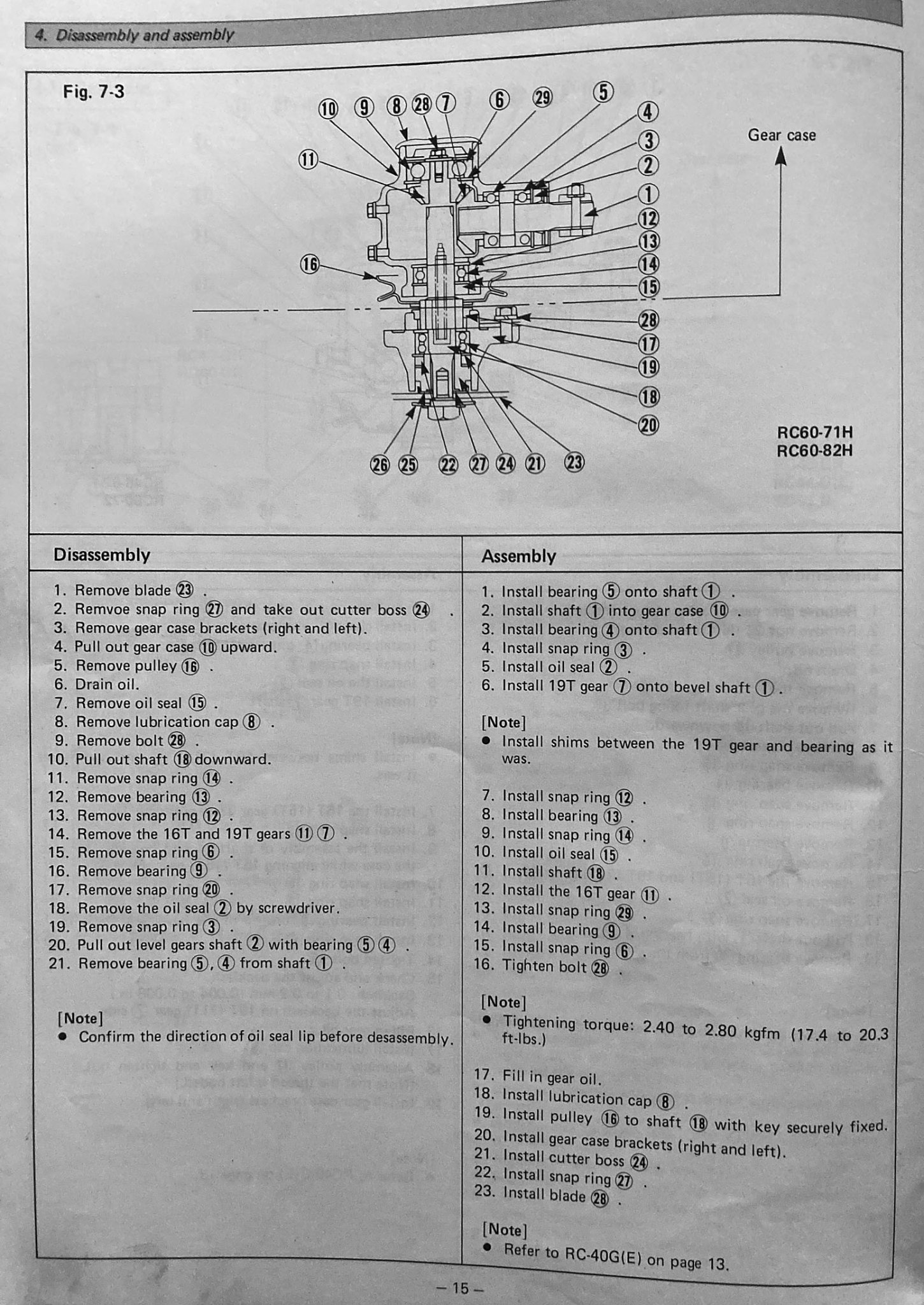

Attached is a page from the service manual. It's not for your specific model, however, I used it to rebuild my gearbox and should be very similar for all the "H" gearboxes.
THANKS LARGE!! Exactly what I was looking for. Have it saved to downloads.

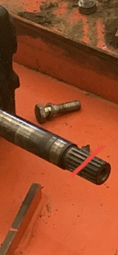

This isn’t your exact box, but I’m betting it’s similar. Snap ring should be under the cup on bottom of deck. Red line. Once that is off, belt removed and 4 bolts holding box to deck, the box should lift off. The snap ring you removed holds the gear on the shaft inside the box.
Thank you sir, pictures help greatly.

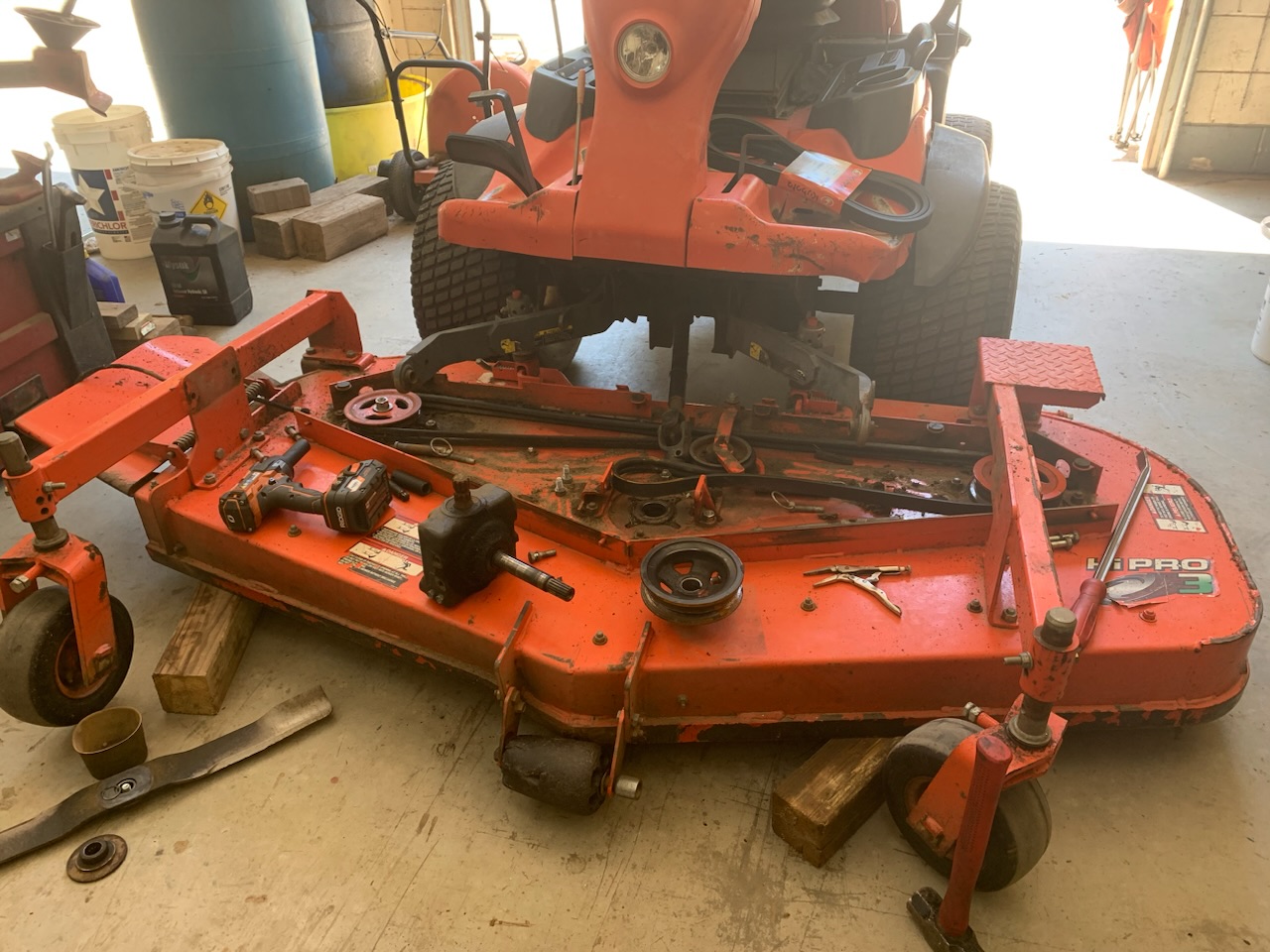

Easiest disassembly of the entire deck, once you know how😁 Thanks to you and all who replied, your assistance is appreciated👍
