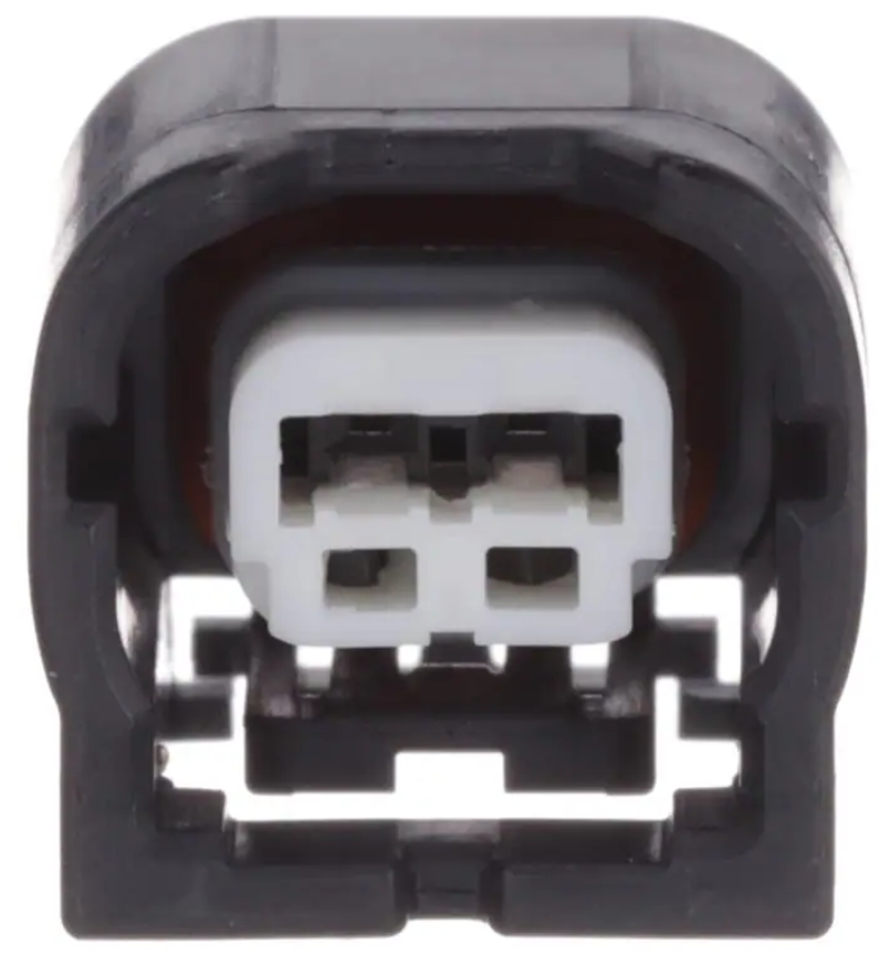

Thanks for all the replies! I found the wire connectors @ Findpigtails.com they have about every connector known to a man, I sent them pics of the connectors and they replied quickly! 80.00 each not cheap but better than the whole harness!!

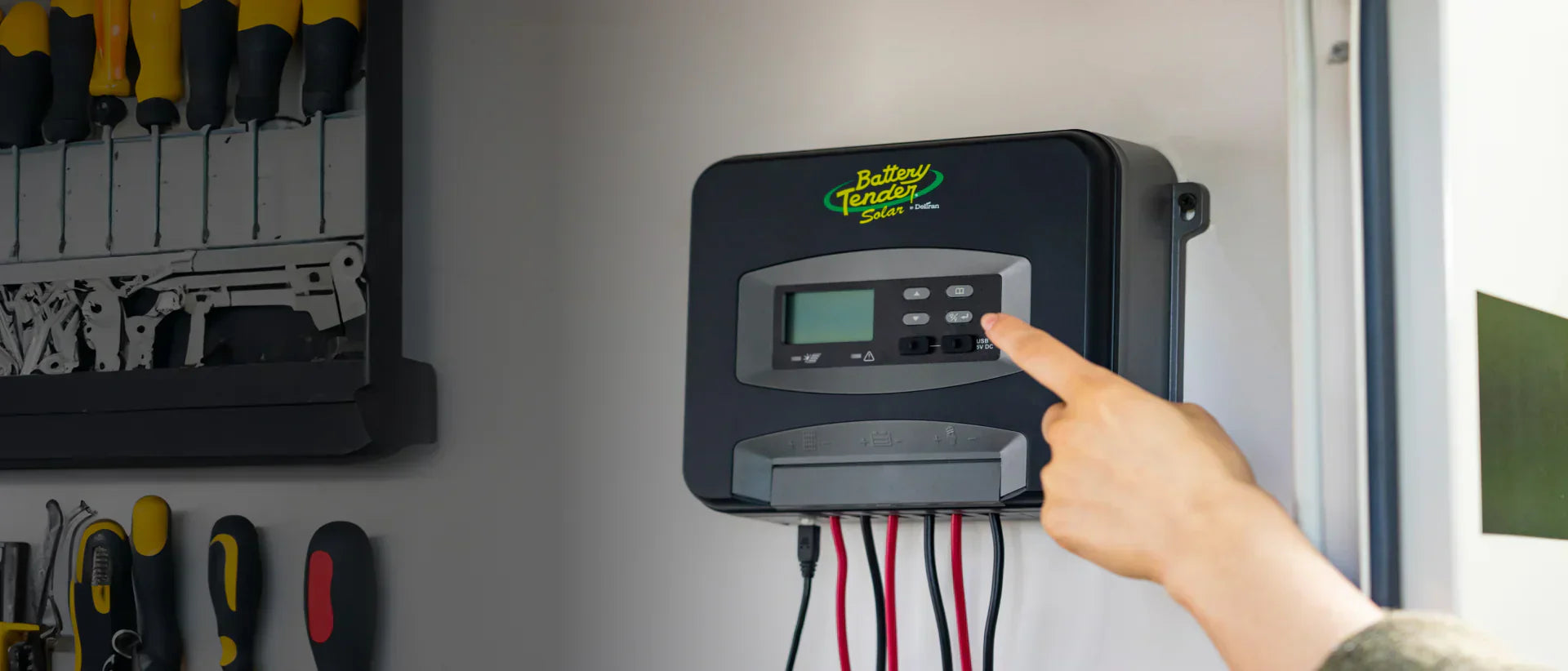

I also use a 30 watt solar panel where I don't have electricity.
it runs down to a Battery tender solar controller (small box) and then the leads go to the battery.....
same as the regular electric chargers.... works great.
