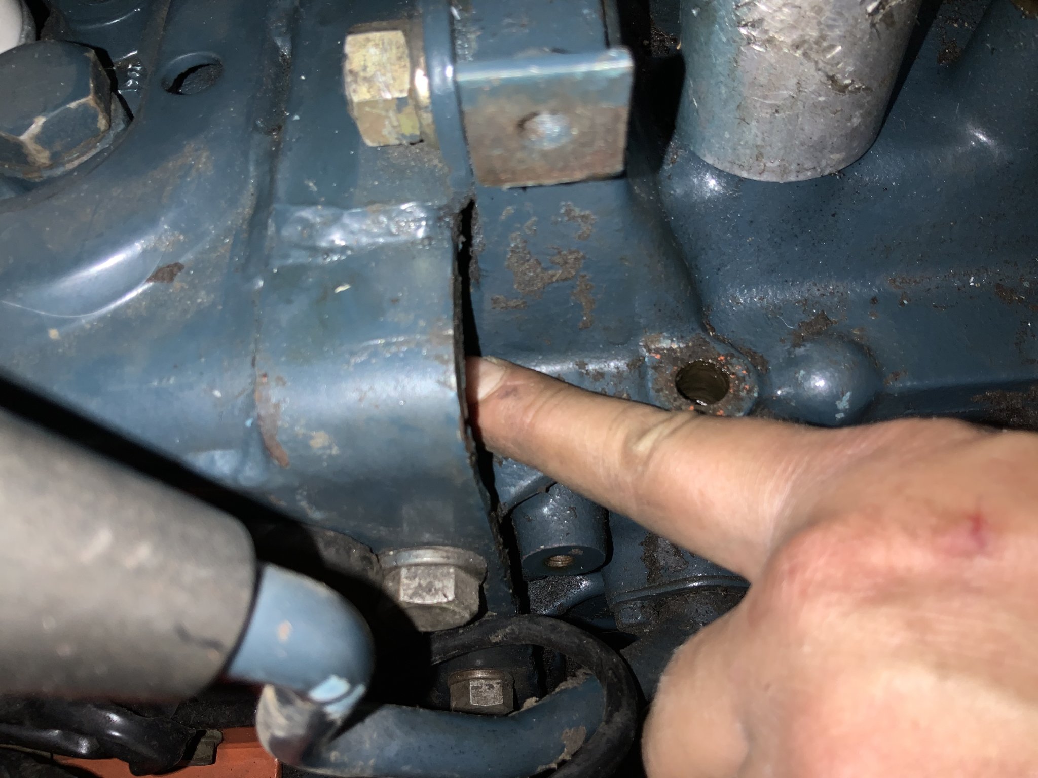

The lever acts as if it is disconnected internally
TRACTOR WILL RUN IN HIGH OR LOW IF TRACTOR LIFTED BY FORKLIFT IN FRONT OR REAR
IT WILL FIND ITS WAY INTO NUETRAL ON THE FLAT { seems as if shuttle w hi low and nuetral is free floating in and out of range to nuetral}
RANGE LEVER SEEMS TO FREE FLOAT
YES I HAVE MANUAL. ( admit hard for me to interpret )
QUESTION
1. HAS ANYONE EXPERIENCED THIS , I have checked roll pin on lever /ok
2. CAN I REMOVE THE FRONT GEAR CASE COVER ( houses hi low nuetral / pto /4 wd gears) WITHOUT SPLITTING TRACTOR?
ANY HELP MUCH APPRECIATED BY NEWBIE TO KUBOTA THOUGH VERY OLD MECHANIC
THANKS CHARLES [ tractor w 300 hours original paint a plus condition except for range select issue}
note /photo attached of cover , two front bolts we can’t get to ( finger pointing) unless we are missing something
QUESTION
