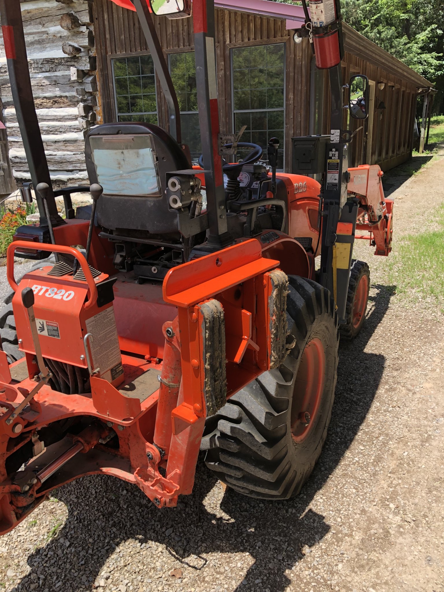

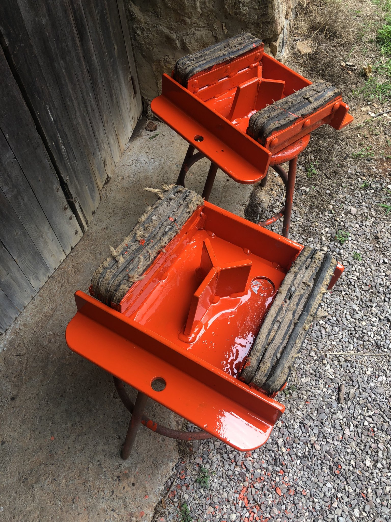

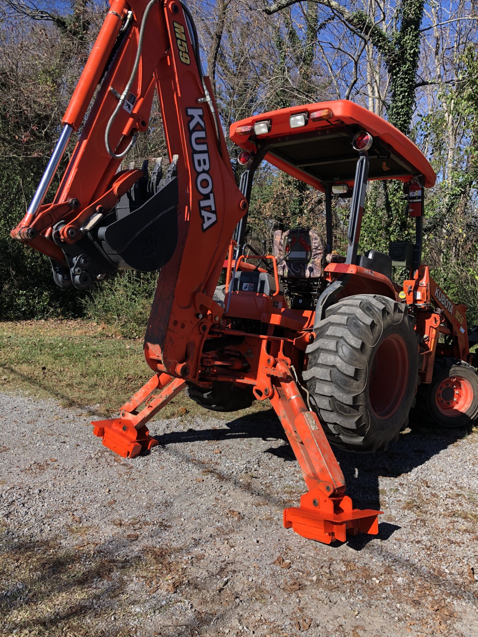

Found the stock stabilizer pads less than adequate on both the M59 and B26. Once they sink into the ground less stable. Add hillside operation less safe. OEM rubber pads help and add 3” height. Added steel tubing, angle and cleats for additional height and doubled pad area. So far been pleased with the modifications.
