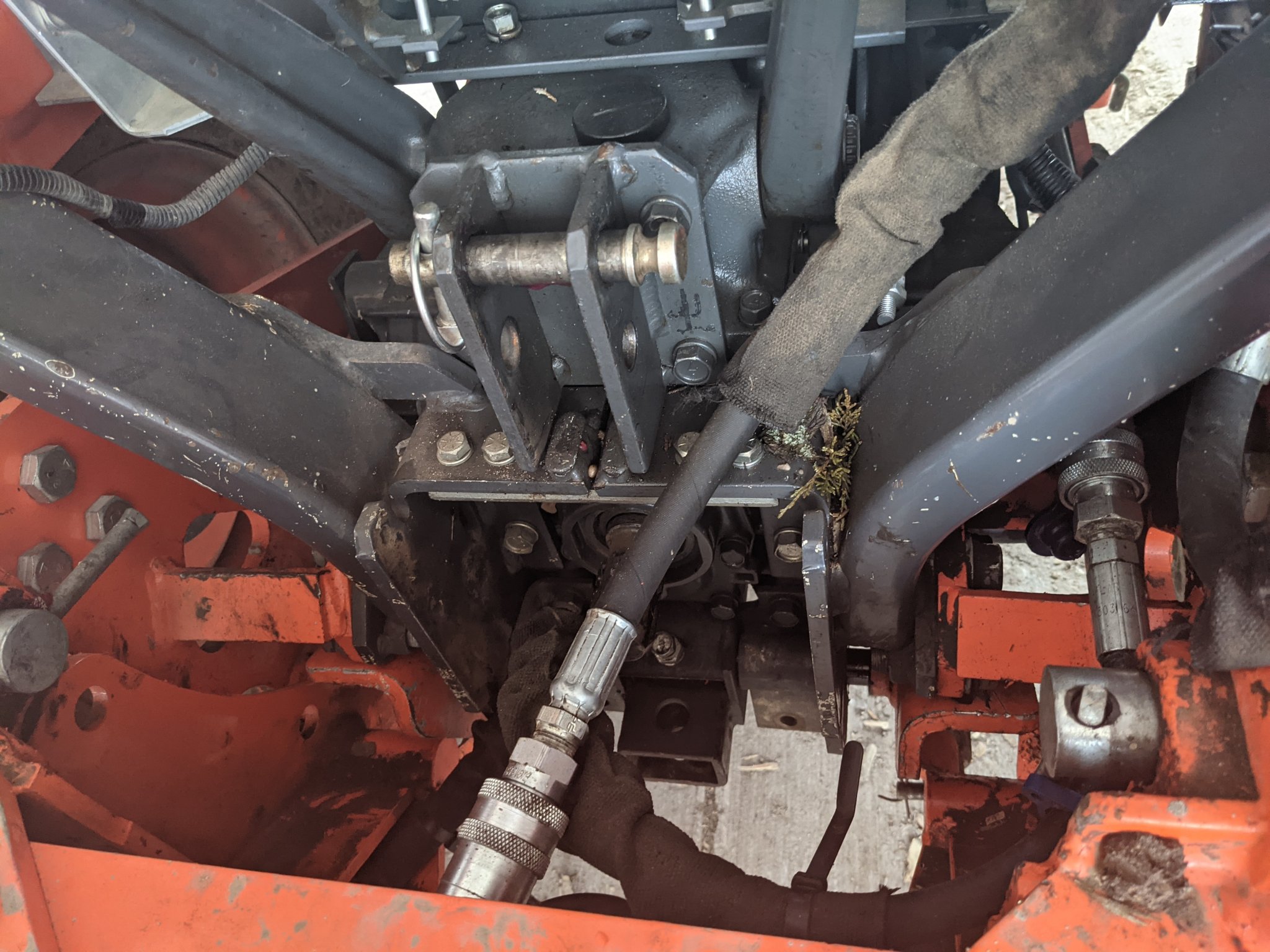

I just purchased a new to me but used 2012 B3200 and can’t figure out how to raise and lower the belly mower? Is it because the backhoe attachment is on? What lever would do it? The “hydraulic control lever” seems to bind up the pump when I pull back on it so I didn’t do that to much.

The mower should be pinned up at the front af the deck. The deck is raised and lowered by the 3pt control. If I am thinking correct your lift arms are removed when the backhoe is on if this is correct then you can’t unpin the mower the lift arms are used to raise the mower.

So my BH77 is installed, lift arms are removed. So once the mower is on it can't be lifted at all?

That is a good question, and I will have to defer to someone with more knowledge on the particular subject. I do not have a backhoe. But.................................in looking at your pictures, it looks as if part numbers 090 and 100 are in place. Each one of those parts has a small "return" that sits on on of the lower link arms, and moves up and down with the lower link arms. From your pictures, it looks like the movement of parts NO. 090 and 100 are blocked so as not to move. Or.................................................after looking again, maybe 090 and 100 are not in place. Let's see what someone who knows says.
Good luck with it. Sorry that I don't have a better answer for you, but I am sure that someone else will. By the way, the notes I added on the diagram/pic are for me, or the next owner. I put a copy in the box in which I stored the parts.

Thanks. No worries. Ill just have to put on the deck, cut the grass, and remove it each time. Thabkfully the deck sets the height with the wheels, and I don't have that much grass. My concern about not being able to raise it was more about going over obstacles. I wont use the loader or BH with the mower on.
