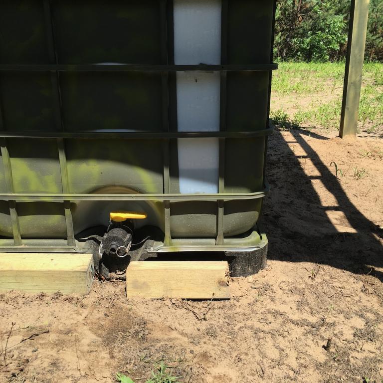

I also use a 275 gallon IBC tote. I built a small rain water collection tank for my primitive camping/picnic area that had no source of water.
The Tote had a cam lock type outlet and there are many places to buy garden hose adapters.
The 8 x 8 metal roof collects about 37 gallons per 1 inch rain fall. On mine I made a filter at the rain gutter to filter out the large pieces, then a fine mess screen at the tank top as a finer filter and keep mesqutios out. Not water I drink but its clean enough for washing dishes etc. I also have about a 40 foot run down hill with a ground level 40 gallon stock tank that I feed by gravity.
I painted mine a green drab for fun, but being painted does serve the purpose of inhibiting algae to grow inside the tank. I left a unpainted strip to I can easily see the water level.
The other nice thing about using a 275 IPC tote for your use is that it is all set to go with a plastic pallet , fork friendly , and easy to adapt a garden hose to.
I picked mine up for $25 dollars but I see prices from that to $80 dollars for food grade totes. Which means that you do not have to worry about cleaning oils or other toxic liquids out of the tank before use.

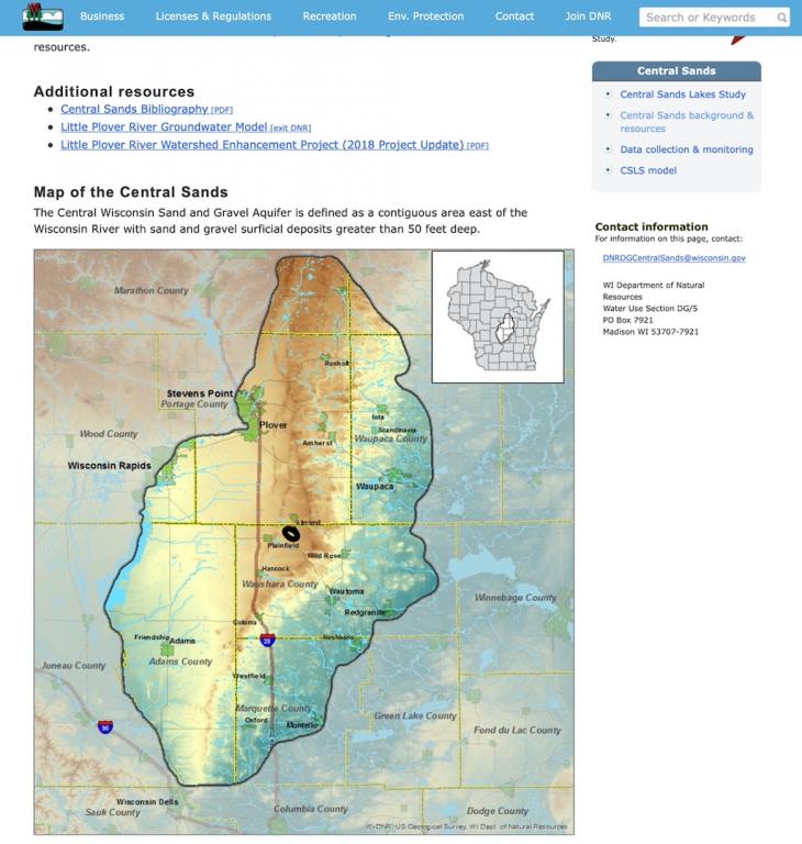

Here is a good map outlining central sands region from the DNR website.
A lot of potato farming in the area. At one time the central sands had many Christmas tree plantations. My land was a former Christmas tree plantation up until the mid 90's.
I marked the map with a black circle showing the approximate location of my place.
