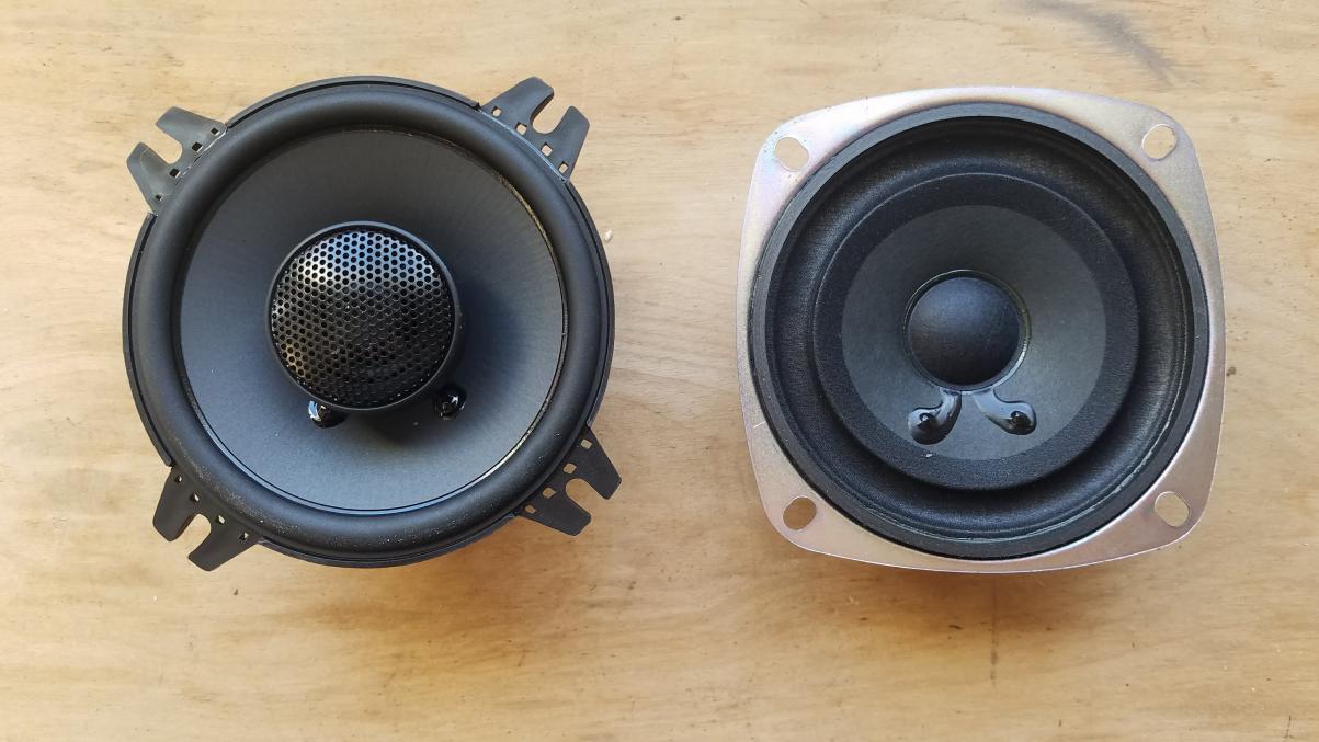

After removing the speakers I quickly realized that Radio Shack must of had some kind of DIY project speakers on their going of business sale that Kubota took advantage of because these speakers are an absolute joke. Not mad at Kubota or anything, I get it, just, wow.
Immediately went to Amazon for some 4" speaker options. Now, I was not expecting anything exceptional in a 4" Coaxial (2-way) speaker, but, at least it would be coaxial.

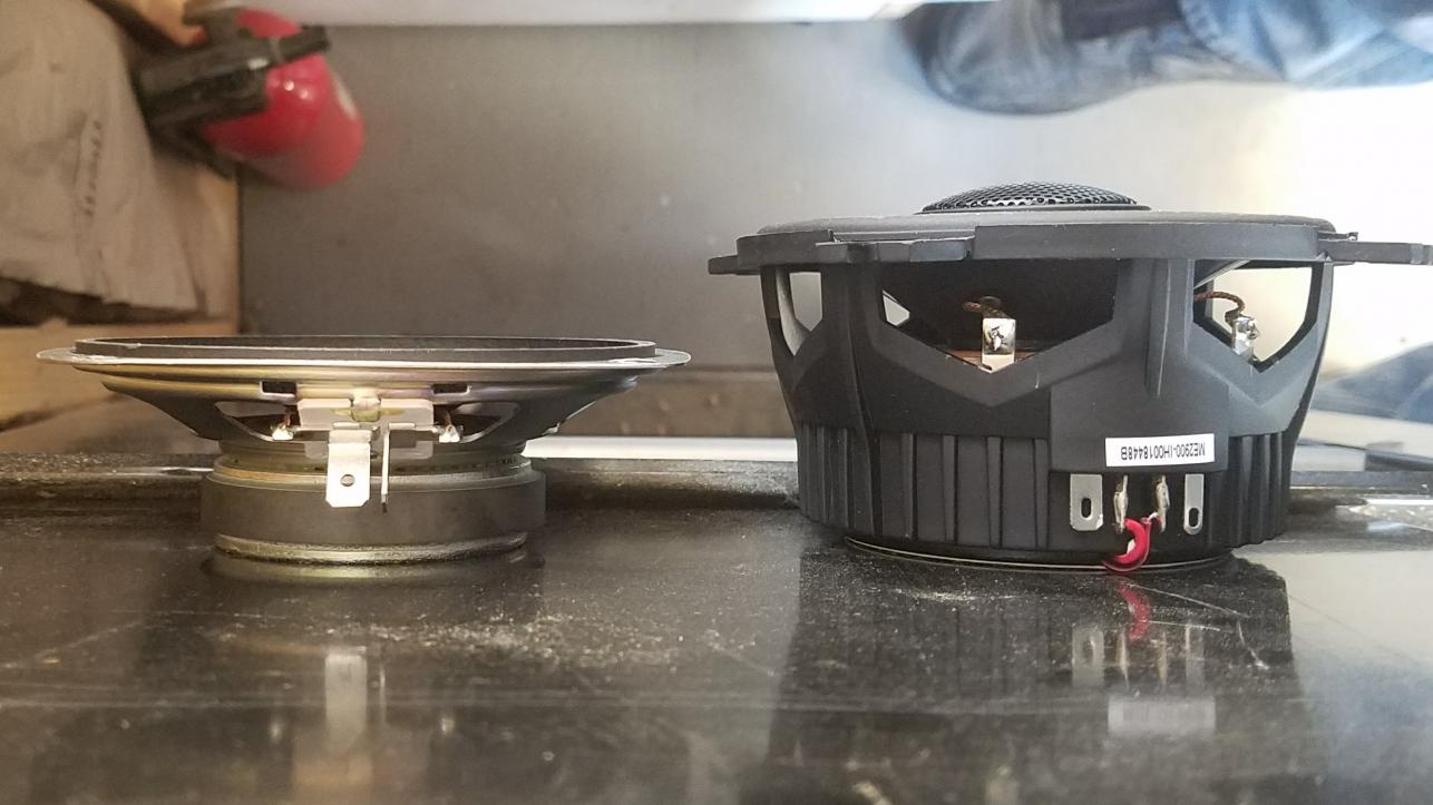

Kubota uses an 8-ohm Clarion 25W speaker. On the tractor side there is a proprietary 90' angle plug that makes it impossible to simply plug in standard speakers. However, the connector is standard so you just need to get some male and female connectors. I soldered on (see picture)
JBL sounded better than the Clarion but will too bright sounding. Very piercing sound when loud. This speaker also did not fit into the Kubotas left housing. The speaker was just a bit too deep, but did work to test.
