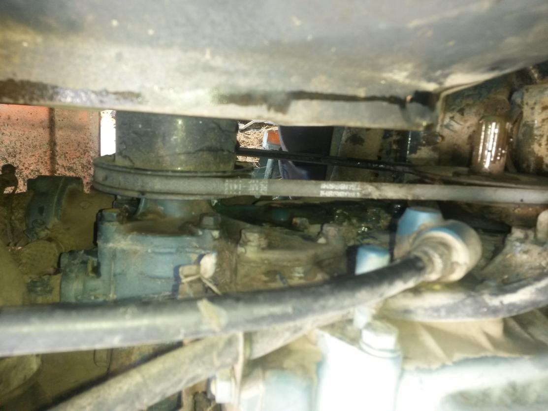

Its a grey ZL1802DT was carrying wood in the carryall and a friend noticed raditor fluid pouring out.
After some inspection it is coming from the top fan belt shaft.

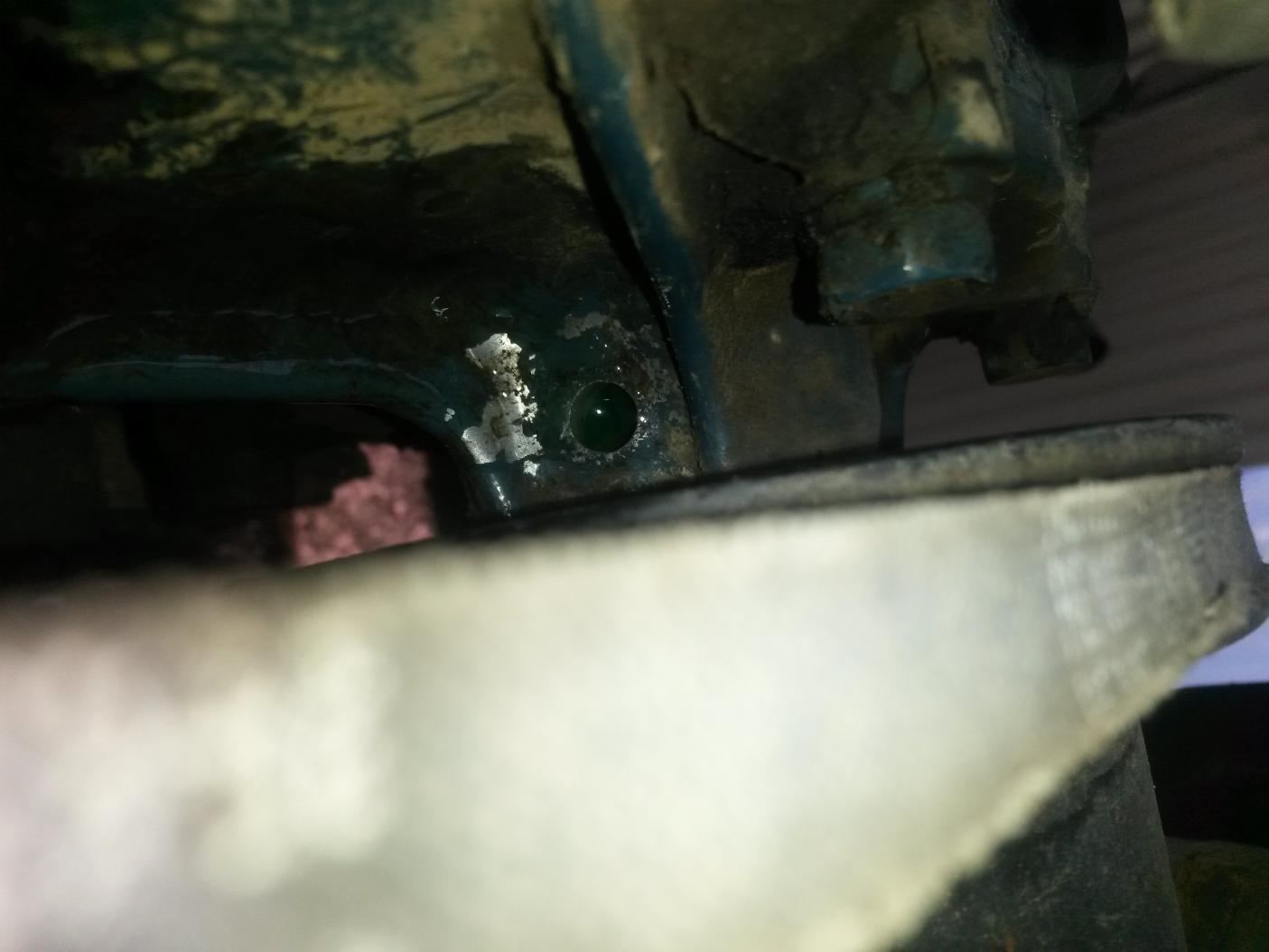

And using the phone camera i notices that its a hole, not a crack, that the fluid was coming out of. uploadfromtaptalk1428631440018.jpg
My guess is a nut got loose.
I am outside of us/Canada so unable to get the visual catalogue from kubota to double check.
Any help regarding parts number for this nut would be appreciated. My concern is not using the correct nut length, or even if it is a nut!

The hole in the second picture appears to be the weep hole in the bottom of the water pump.
If radiator fluid is coming out of that hole, then you probably have a bearing and seal failure in the water pump.
That will require a water pump replacement.

Thanks for that. I am so glad now that i posted this. Imagine plugging that hole up!
Might take a quick look on the internet and see if replacing a water pump is doable for a novice.
