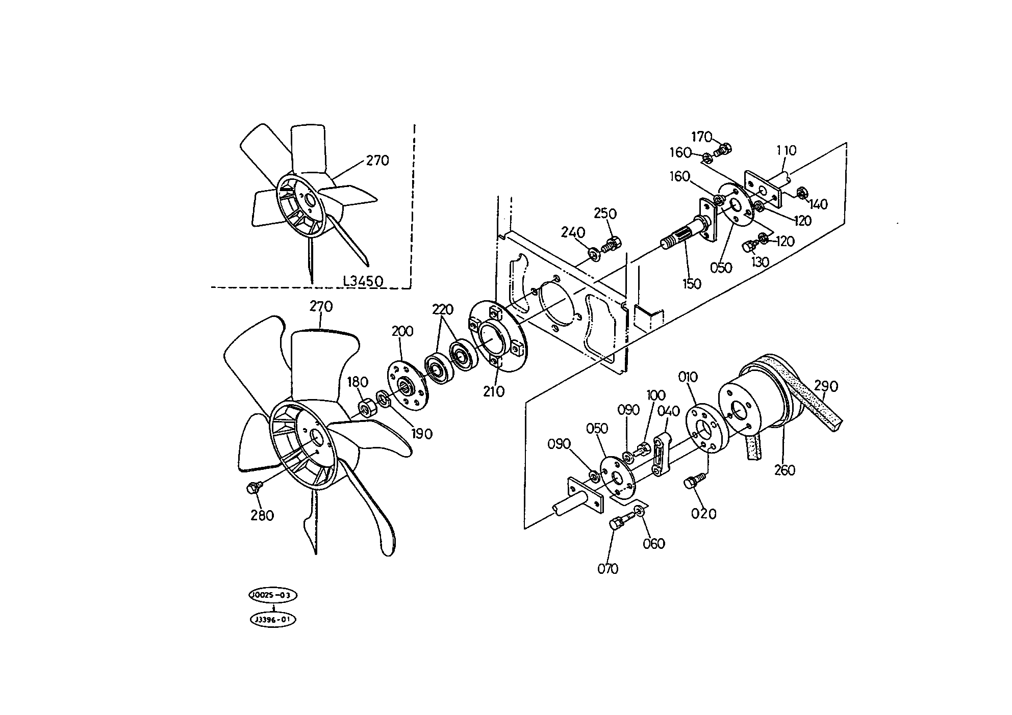

hope to float Active member Lifetime Member Equipment L3450 Feb 18, 2018 483 61 28 Ireland Jul 8, 2024 #1 The carrier bearing on the radiator fan wore out. I have the shaft taken out but can't figure out how to get the end off the shaft to replace the bearing. Is it threaded? And if it is, is it left hand thread or right?
G GreensvilleJay Well-known member Equipment BX23-S,57 A-C D-14,58 A-C D-14, 57 A-C D-14,tiller,cults,Millcreek 25G spreader, Apr 2, 2019 12,863 5,612 113 Greensville,Ontario,Canada Jul 8, 2024 #2 Is this what you have ? If so #200 should just pull off of #150 (straight splines) ?? Reactions: 1 user
hope to float Active member Lifetime Member Equipment L3450 Feb 18, 2018 483 61 28 Ireland Jul 8, 2024 #3 GreensvilleJay said: View attachment 132360 Is this what you have ? If so #200 should just pull off of #150 (straight splines) ?? Click to expand... That's it exactly! Thanks
