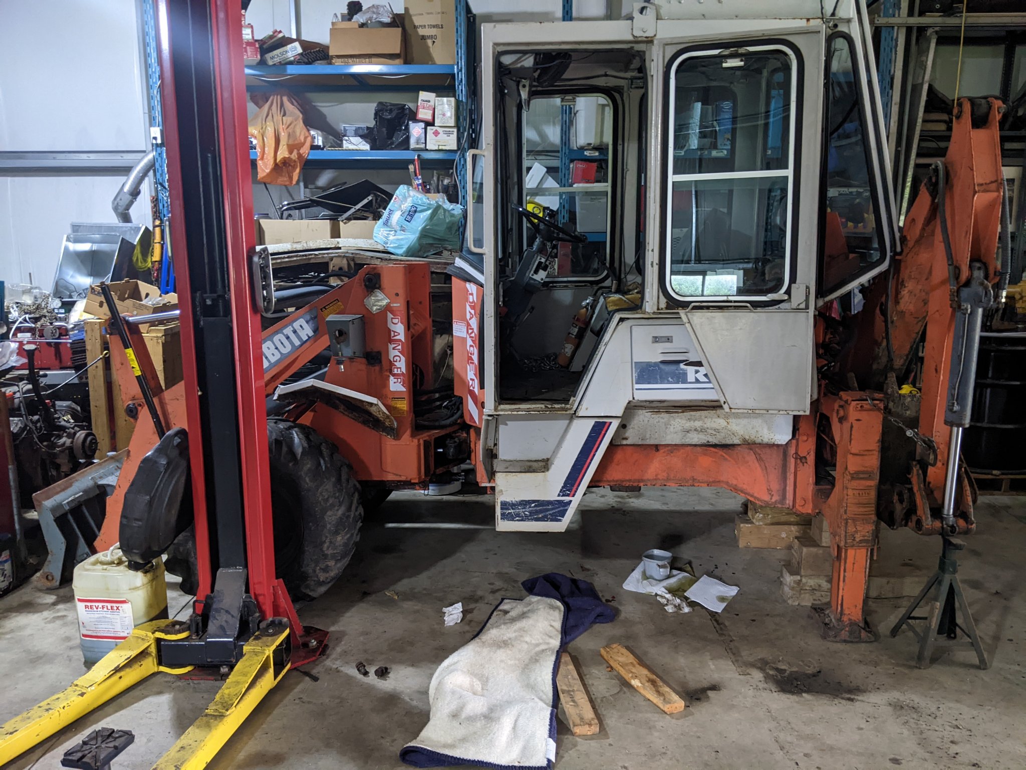

Yes, I agree, however if it's front wheel drive there isn't going to be any heavy pushing anymore it will be for transport only, I figure it should be good for a while.
I have attached a picture of the old girl.
I agree you will no doubt be doubly cautious of it's limitations, but you're still operating with only half a drive train, even if you don't put much extra stress on it.
