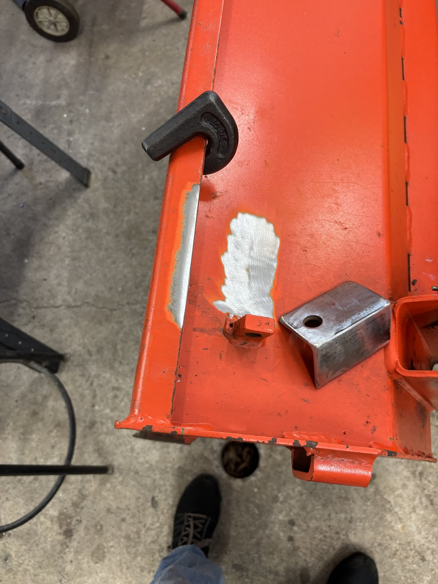

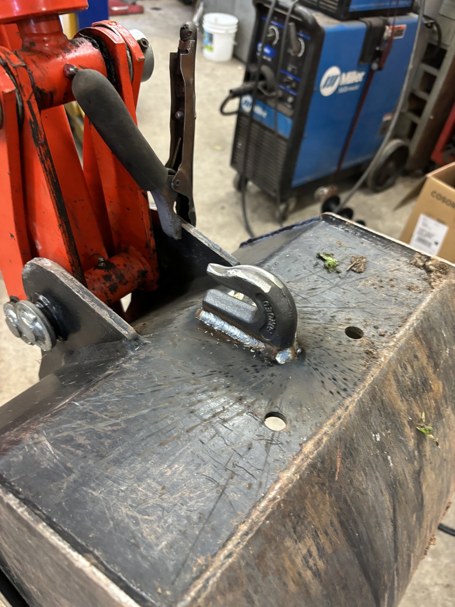

Total of 45 mins less the paint to do later.
Cost about 2 bucks not counting wire and gas. Just 2 hooks no need for center hook as try not to smile weak bucket or add to much weight.

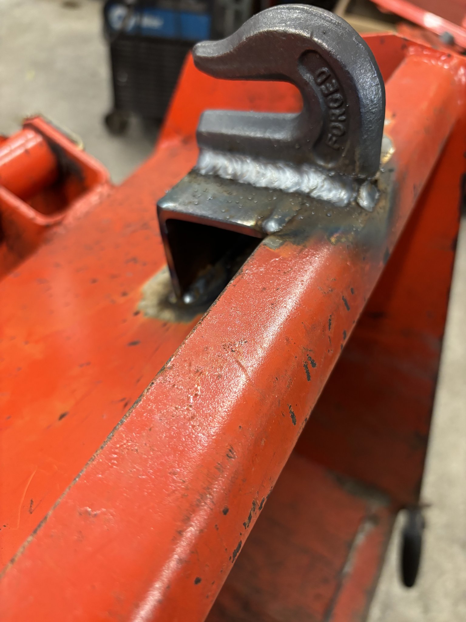

Looks great. (y) (y)
Nice welds and good idea on using the "L" bracket!

Thanks buddy. Just 1 piece of scrap Jasper using to hold torque converter in shipping. I cut em up and use them. Free is free…

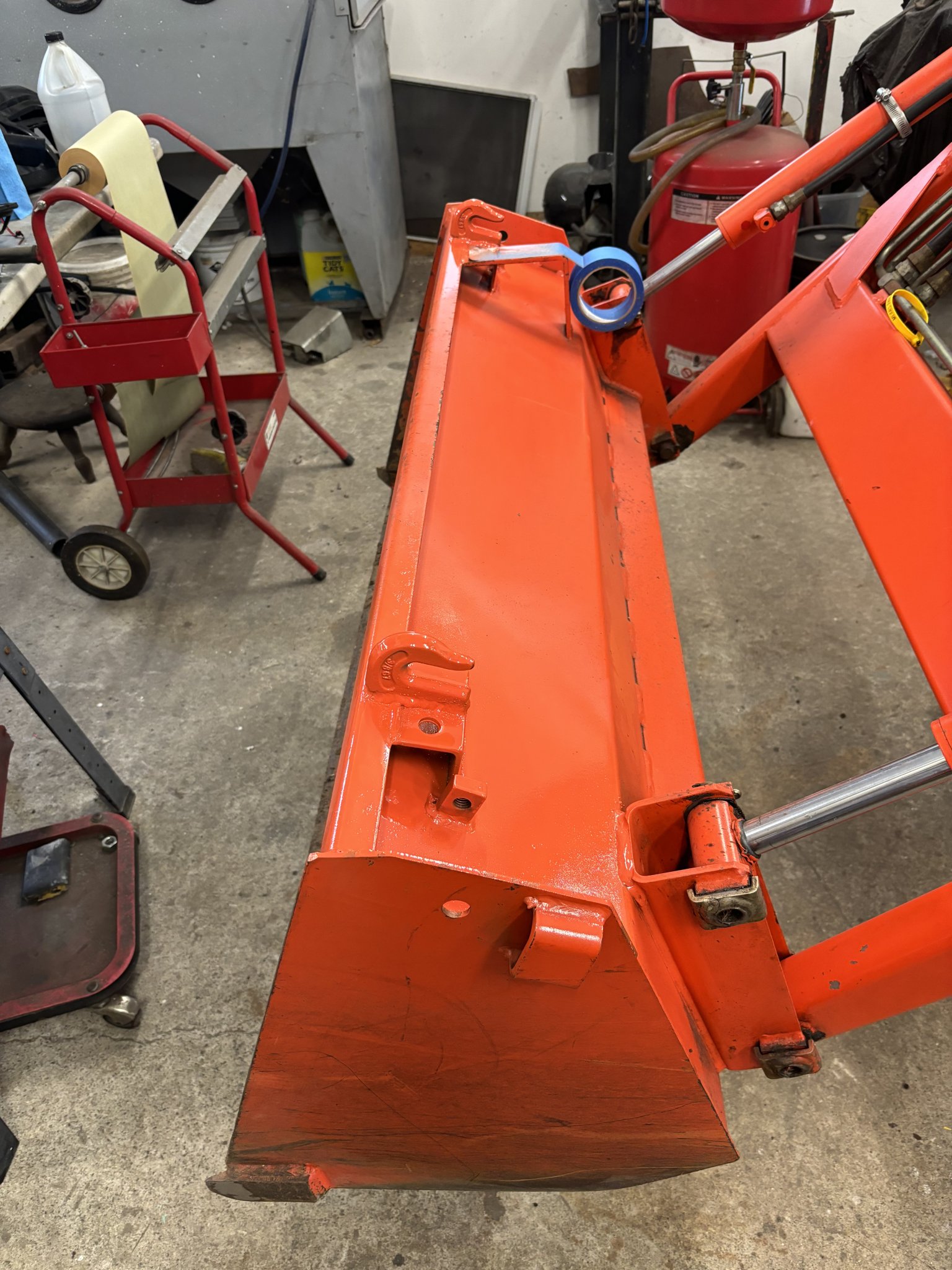

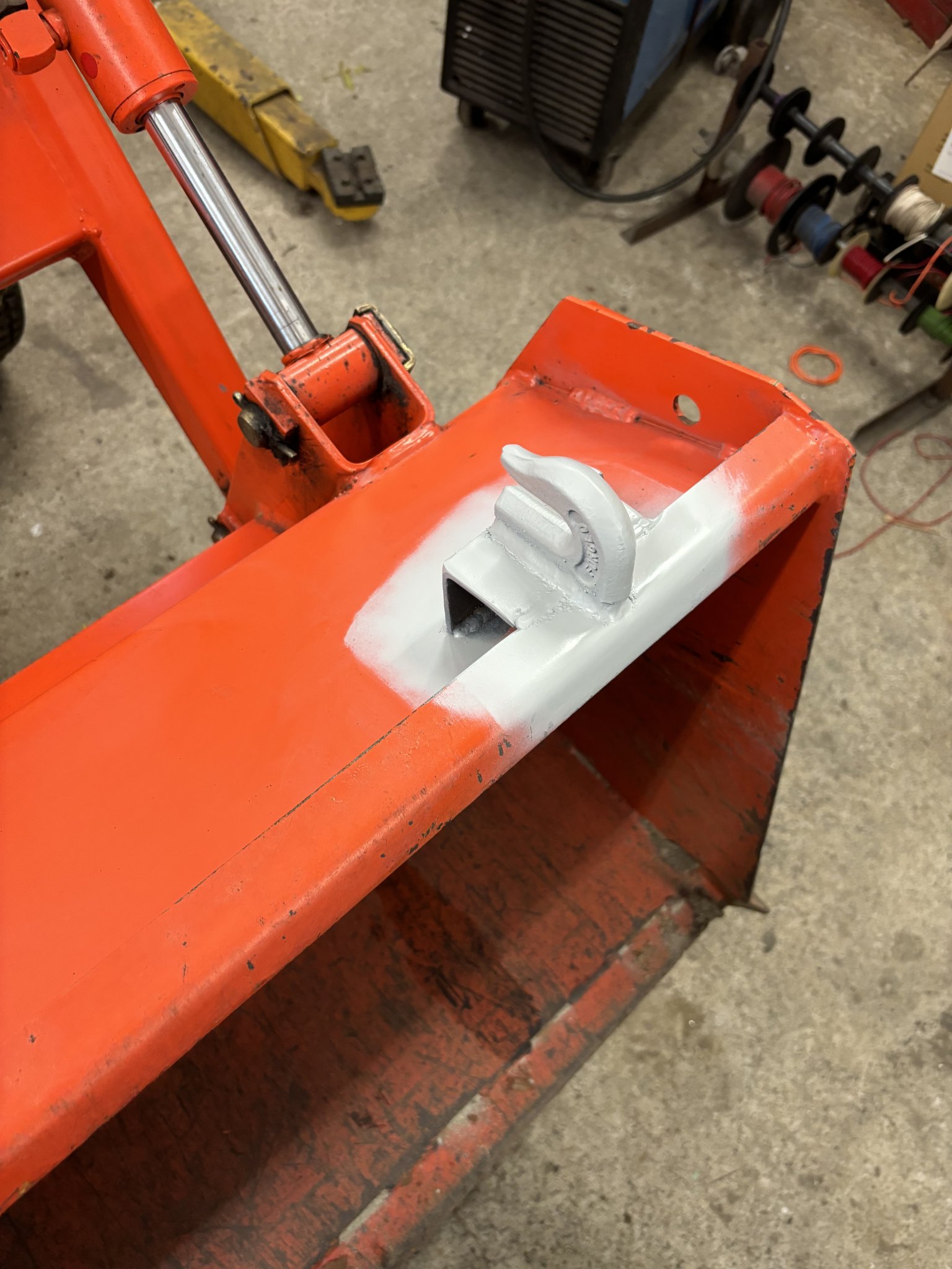

Ok almost broke the 5 dollar budget but than remembered i have orange paint for my S250 bobcat. I know not the same color but good enough for free.
Took longer to paint than to cut and weld up. Off to the beer store for rewards 😎🍺🍺🍺

Thats actually a pretty close match from this standpoint.

curious... why didn't you put them at the corners of the bucket, which 'technically' would be the strongest point ?
10,035
6,846
Not sure what you mean by “corners”
I can’t speak for @Oleracer, but often folks like to put bucket hooks in line with the loader booms and linkage to the bucket.
Looks like he placed them exactly where I would have.
Exactly were they should be. After about 20 or more sets i think this is the best in line with cylinders.
But i am sure much smarter people think different.Thanks for your concern..🍺

must be the camera angle, they don't look inline with the cylinders.to me
if they were welded to the side plates, it'd add additional strength

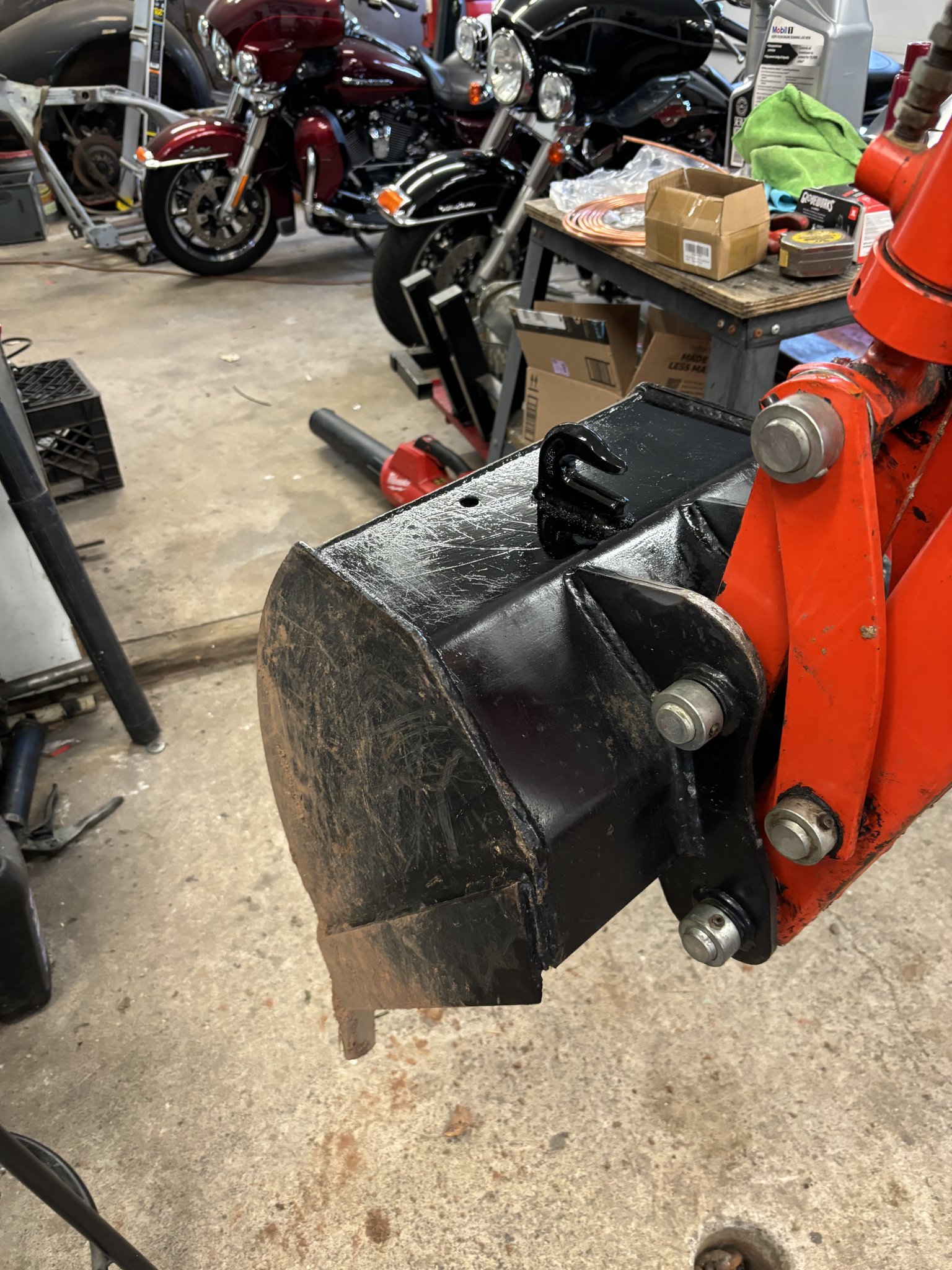

The last one on the hoe… DONE
