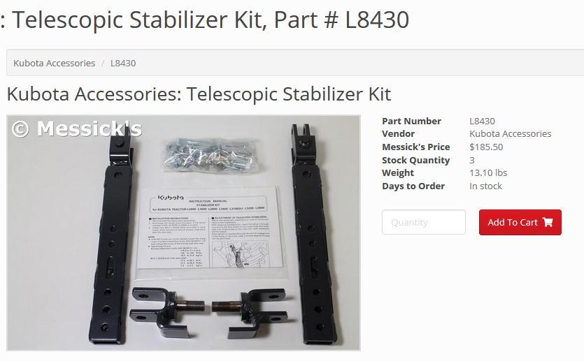

What you need are the kubota telescoping stabilizer bars. They are a godsend and make attaching and using attachments easier. I fitted them to my L3200 and L3901. Google them, about $200 pair and 30 minutes to fit.
good luck

A quick hitch will still allow the three point arms to rub your tires if the stabilizers are not adjusted properly. Get the mower to level ground and adjust your stabilizers so you have a little play but not enough to rub the tires. Tighten the jam nut. Telescoping stabilizers will make the job much easier.

Messicks Part No. L8430 $185-50 + Shipping. These were the best modification I made to my smaller tractors.

Sounds good. Will the telescopic stabilizer keep my cutter running straight during continual heavy cuts? And what type of adjusting is necessary? Thanks for your help.

I have the QH15 and the recommended stabilizer kit above (came standard on my tractor). These have worked fine with my RCR1272 and no issues with it shifting and hitting the tires. It keeps it nice and aligned behind the tractor.
The QH isn't needed to accomplish the alignment, the stabilizers will do it. The QH just makes it easy to change implements for me.
