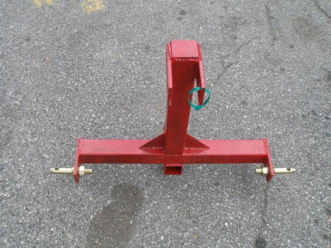

Here***8217;s a QH compatible for Cat 1. I have one from Titan and it works well with my Agri Fab/Speeco QH.
https://www.palletforks.com/three-p...y-category-1-3-point-2-receiver-hitch-v2.html
Sorry OP, thought you were looking for a Quick Hitch. I did get one of these receiver hitches the other day from Titan. Mine was either $74 or $79 dollars. The link Mainah posted is nice as well but a little more expensive.
If you do get one from Titan, they don't come with the top link busing, so pick one of those up if you don't have an extra.
Could not believe how fast this hitch arrive. Three days after order.
