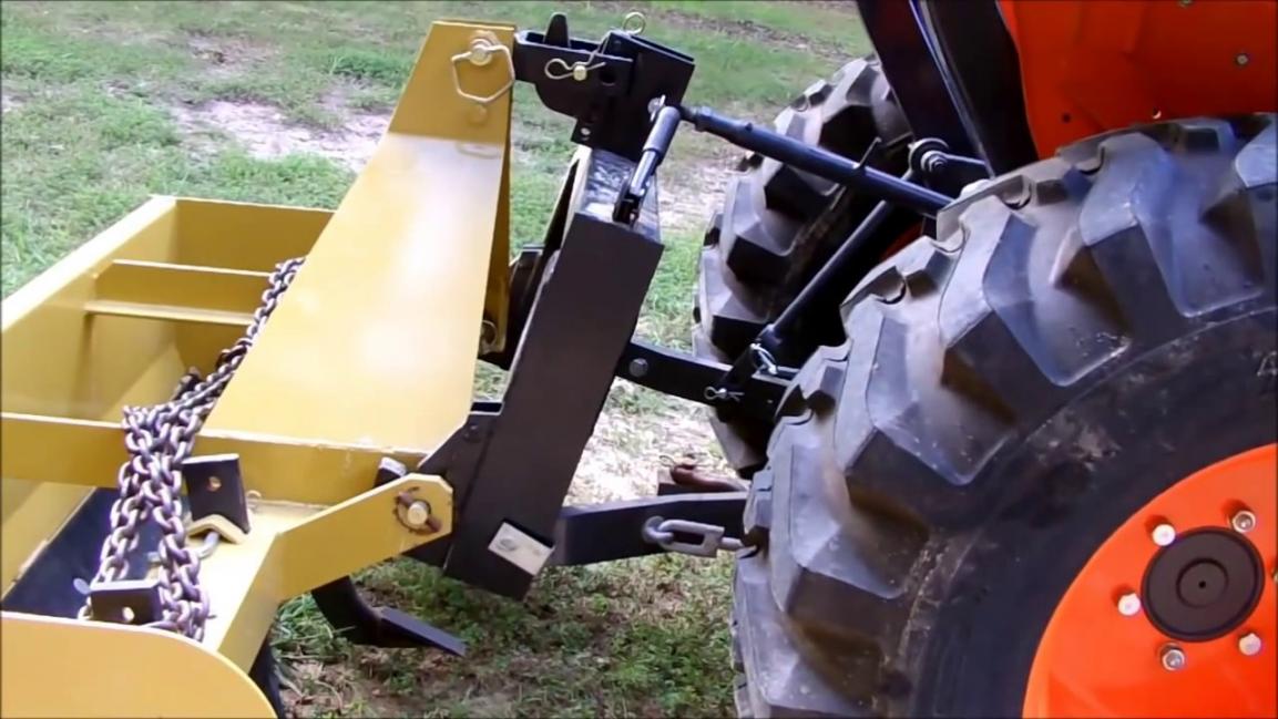

I'm not clear on what you mean by the U shaped bracket, my box blade was set up similar to the one in the picture. What I did I re-drilled the rear arms to a forward position on the bottom, then re-bolted them to the top hole in the vertical arms and used the remaining bottom hole in the vertical arms for the top hook of the quick-hitch. I found that to be the easiest and fastest (and cheapest) way to convert it to being compatible. Hope this helps you out.

Sorry for the confusion......my primary concern is how to hook up the lower arms of the tractor, to the corresponding brackets (as pictured) on the box blade. If this is what you're addressing, a photo or two would really help. Thanks.

I really missed the mark on that one, on my Cat. 1 quick hitch the lower hooks ID is 27 1/4" and the OD is 29 3/4" if that won't work for you you'd have to move the brackets on the box blade. I think all the lower brackets are the same distance apart on the newer equipment. You probably have a Cat.1 hitch with the Hp that you have, so if your buying new make sure the equipment is quick hitch ready or get out the welder. In my first quote I was explaining what I had to do to make the top hook work.

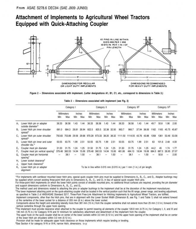

Kenny, thanks for posting the standard dimensions. Figured there had to be some baseline. Wish that it were being followed by implements and quick hitches.
My measurements on my implements and the advertised dimensions on the (low end?) quick hitches show way more variation than mechanical tolerance and mud/ice tolerance.
My comment is that anyone thinking about quick hitching should measure what they truly have, "as-built." The quick hitch(es) that they are exploring should be measured "as-built." Then a decision can be made whether to weld and modify, and which ones, or some other scheme.
