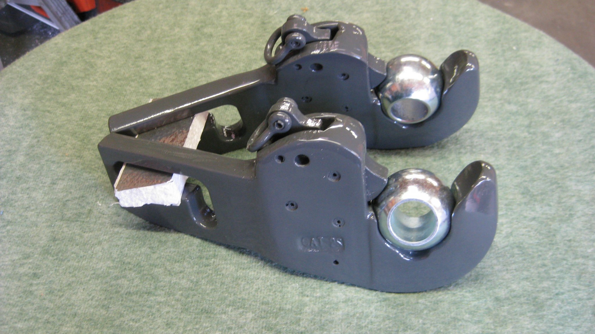

I went with Pats Cat2 and euro ball/hook top link. Hopefully that will prove better than a standard QH.

Euro QH hooks work with any width that your draft arms will reach. Cat 1 & or cat 2 connections, same hook, different implement balls.
Just another option to consider.
